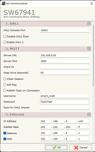

I have the ADF DALI/MQTT Converter (HD67941) but didn’t have any luck getting it to work.
When trying to connect to the mosquitto server on my home assistant instance I get the following error:
“Client disconnected due to protocol error”
This is my MQTT Configuration that i synched to the DALI/MQTT Module:
Any help is greatly appreciated.
Thanks.
Akio
Hello @wolfmar80
here my configuration page.
It’s strange that you are not able to connect.
Did you try with another connection like MQTT explorer?
Dali console port is the same, 10001
Hello Francesco,
I see that you have a Client ID defined and have checked the “Clean Session”.
For the client ID, did you add any additional config to the Mosquitto Broker in HA?
What is the reason behind the “Clean Session” checkmark?
