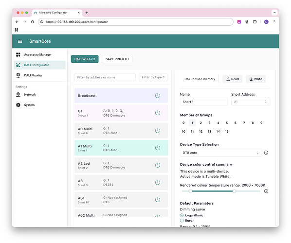

We recently implemented emulated support for Lunatone DALI-2 IoT in our Atios SmartCore device. Meaning you can use the Lunatone DALI Cockpit Software to access your physical DALI bus via Atios SmartCore over IP and address and configure your whole system. See attached screenshot. So 1x Atios SmartCore basically replaces the following set of Lunatone hardware:
  • DALI-2 IoT Gateway
  • DALI-2 PS
  • 12x DALI-2 RM16 / 3x DALI-2 4xRM16 / 6x DALI Jalousie
And you can natively integrate into Home Assistant without the need for another NodeRED entity or similar.

Each DALI control gear (lights), and each DALI-2 control device (sensors) gets an individual DALI addresses assigned. This can be done directly using the embedded web-interface, instead of using an old-school complicated tool like Lunatone DALI Cockpit or Tridonic masterConfigurator which each need their separate USB interfaces.
See the demo here: r12.atios.ch
