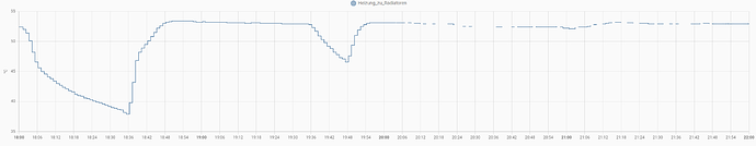

My Dallas temperature sensors send new values every minute via ESPhome. No issues observable in the ESPhome log. However, since Dec 15 shortly after 8 pm (see graph below) after months of uninterrupted temperature data sending and HA automation scripts reading their states, all my Dallas sensors turn “unknown” when their states are check by automation scripts:
Any idea where this is coming from and how I can fix it? I don’t think I changed anything in my system around the time the Dallas sensors started turning “unknown”.
