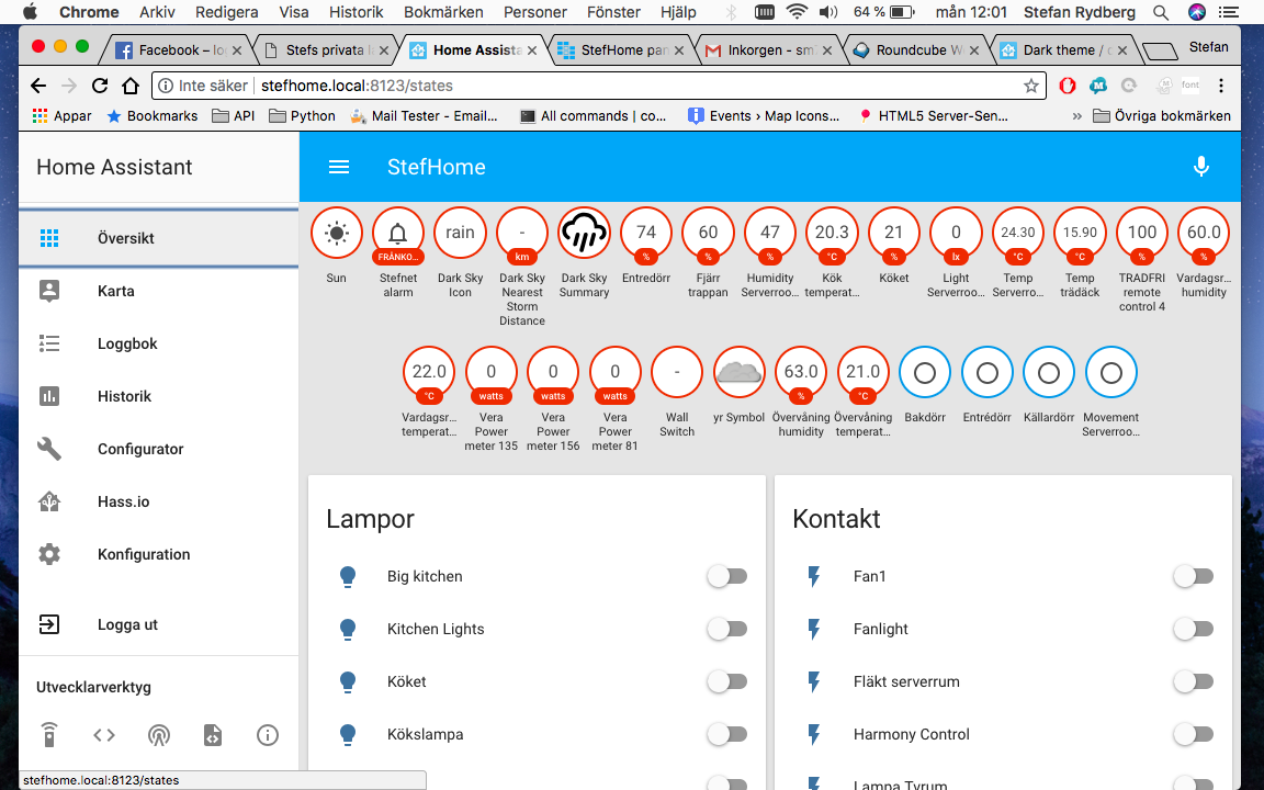

I have read a lot of info about themes and dashboards and it seams so easy to change but i don’t manage to do it. I am visually impaired and the standard light webpage for HA is very hard to read for me. Light blue text on white? Who can read that?
In the configuration file i have make an !include themes.yaml to a file i found on github with a few themes in it. The instructions tell me to just reboot after that and there should be a choice in configuration general, but there is not. Have i missed something? I have also start to make a dachboard in the appdaemon. So far it looks good but i would like to add functions like when i click on a sensor i what to get history on temp like in the frontend on Ha, but i cant find info about how to. Or, there is so much info that dont work that i have stopp looking
