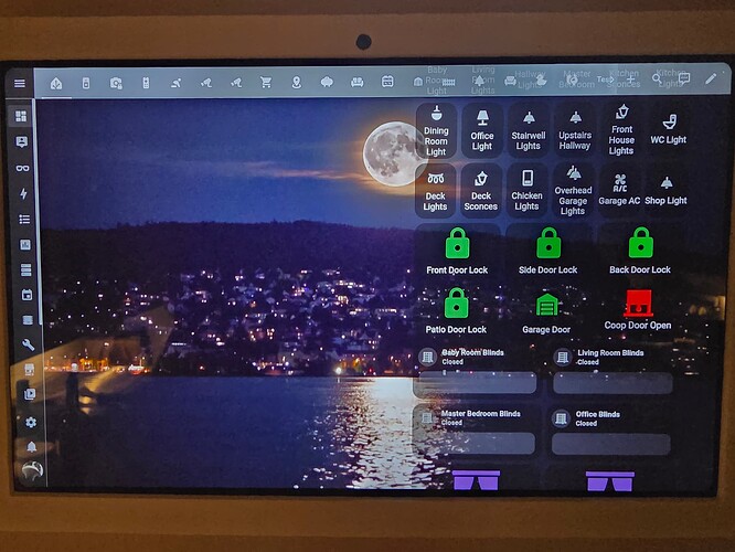

Not sure what I missed but all of my entities are now on the right side of every screen.
Any suggestions?
Any suggestions?
Is it a custom dashboard with a custom:layout-card?
It is a custom dashboard with a custom layout card
And with card-mod?
Its the animated_background: … not sure if somebody will fix it.
Yeah I figured it was that. It goes back to normal when I remove the animated background. But now my dashboard looks boring
