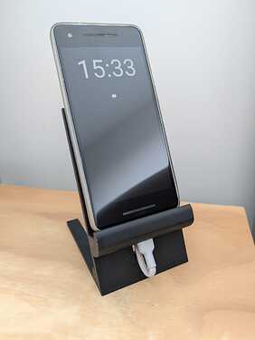

Now that there is wake-word detection in the Android companion app, I finally had a nice use case for my old and trusy Pixel 2 Android phone.
I had it flashed to Lineage OS a while ago, and after updating it, it was running Android 15. I didn’t install Google Apps so I downloaded the latest HA companion app version from GitHub.

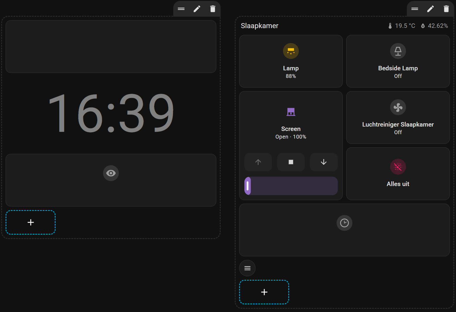

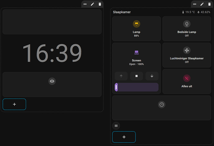

I created one Dashboard with two sections.
  1. The first section shows just a the clock and one additional button to toggle to the control view. It uses an input boolean to determine which section to show. Based on the hour (if it’s even or odd) an empty card is shown or not. This moves the clock down or up every hour, to prevent screen burn-in

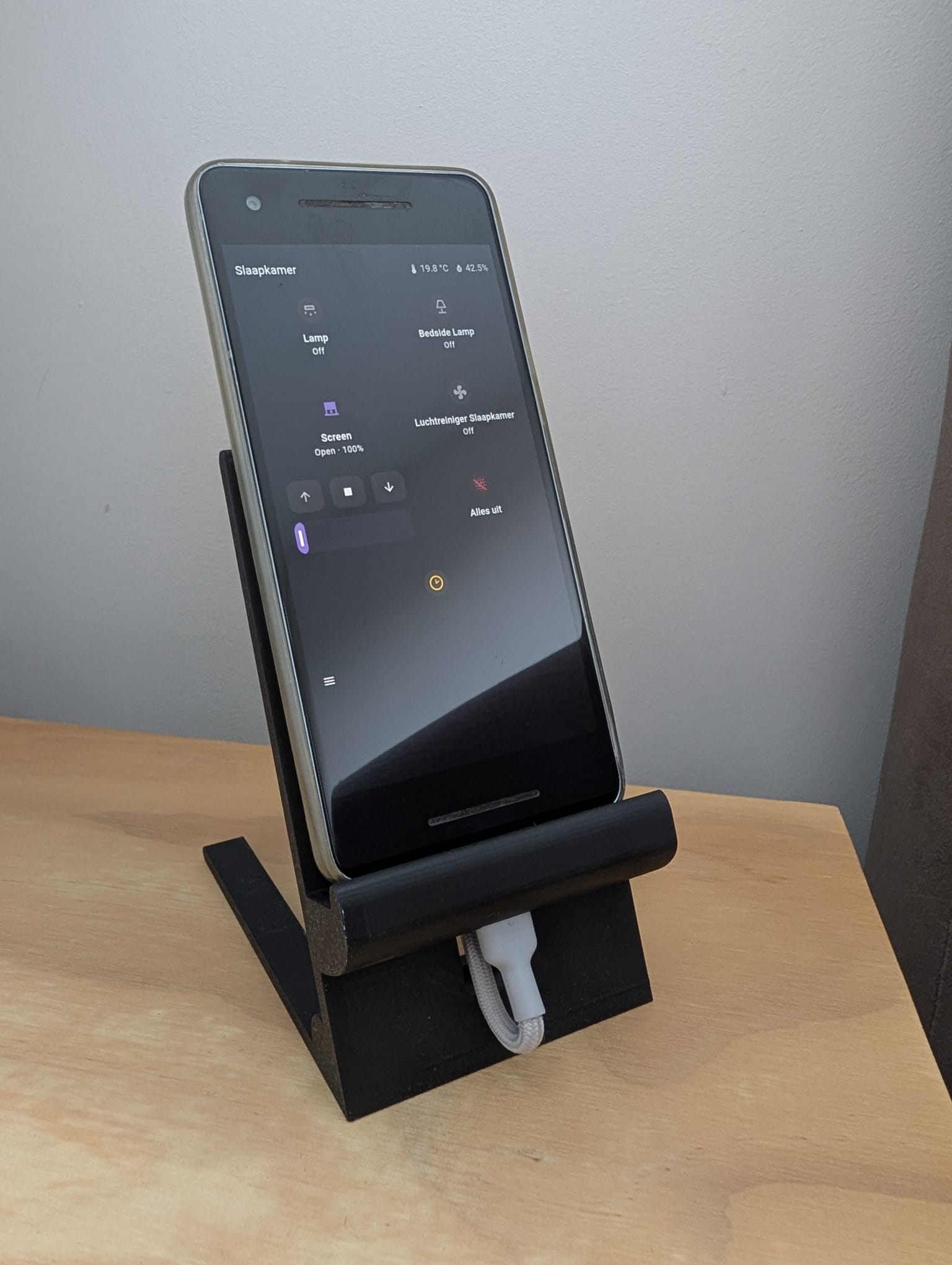

  2. The second sections shows controls for the room, and one button to turn off all lights in the house which might be left on.

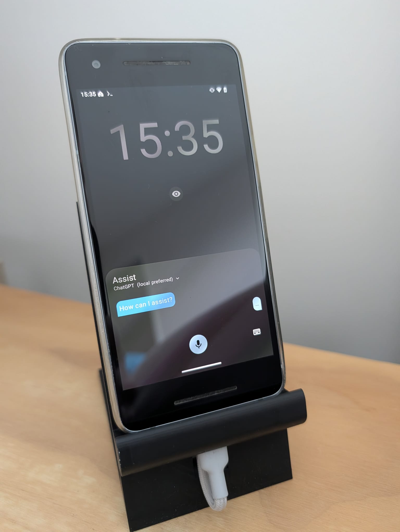

And you can issue voice commands :slight_smile:
One caveat is that the voice commands aren’t area aware, and unfortunately you can’t use continues conversation, so if the response is a question, you need to press the microphone icon to speak.

This is how it looks like in the GUI editor
