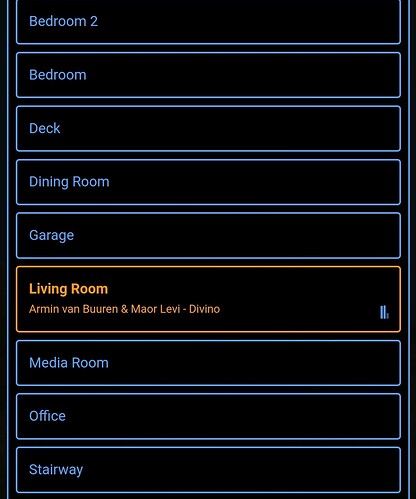

Would it be possible to add an image to favorite buttons that have no image similar to “thumbnail” for “customSources”?
Also, is it possible to remove the media title/artist from the media player entity button, because it’s already displayed in the player on top?
If you have 9 players and they’re all playing different things, how do you tell what is playing on each if this information isn’t with the room name?
By looking at the player, just a request.
I know its just a request. I’m trying to understand the outcome and the unintended side effects.
To learn what is playing in each room, one would need to click on each room one at a time to see that in the player if the song information is absent from the room listings. Is that what the suggested outcome is?
For me, yes, not sure if it would be desirable for all.
So then yes in that case, a way for the user to select whether or not to display the song information with the room could be appropriate.
A “display song information: true” if you will
That would be ideal.
I know I’m probably pushing the limits, but What about adding images to favorites that have no media artwork?
I can’t answer that one. We’ll have to wait for Phil. He will probably be able to provide a feasibility answer quickly. He’ll likely give us a response on the “display song info: true” setting we just discussed.
Awesome, thanks.
Here is a beta for the the “missing thumbnail” feature:
See readme on how to use it (customThumbnailIfMissing).
Let me know how it works!
