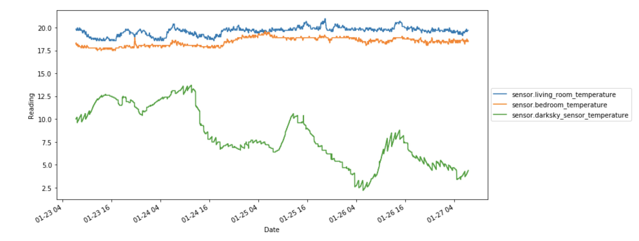

Today @WillKoehrsen and I have released a simple package for parsing data from the home-assistant database. Right now if does basic queries and plotting, but also allows prediction using Facebooks prophet library. This is a WIP but any feedback gratefully received!

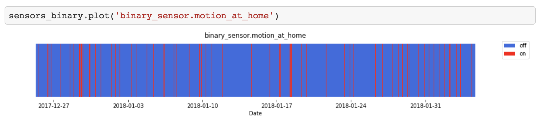

v0.3 adds the ability to plot binary sensors. Cheers to @WillKoehrsen for his hard work on this one.

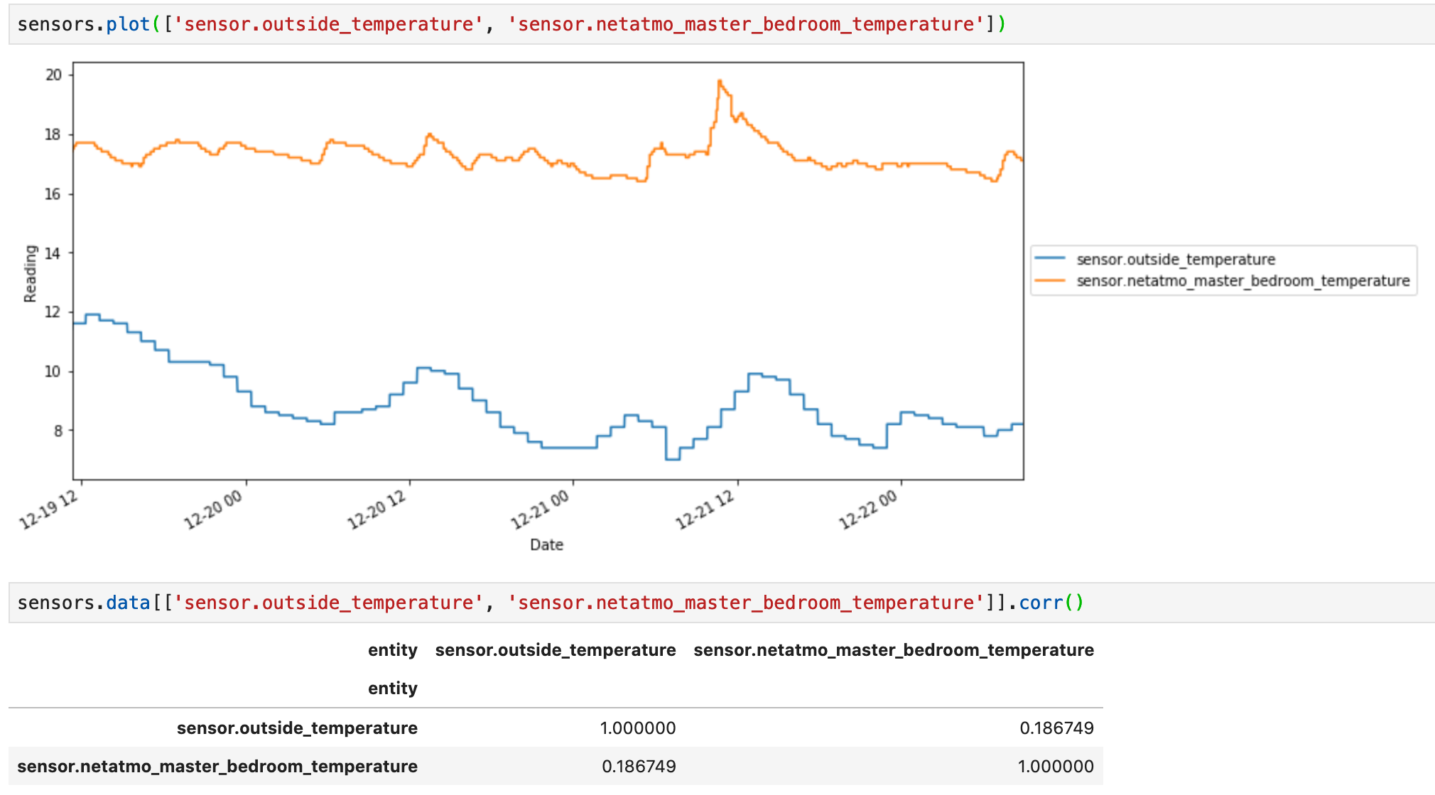

So I did a quick check to see how well my house insulation is doing this winter and the data-detective made it easy to verify that my bedroom and outdoor temperatures are not correlated, indicating that my homes insulation works well
or that you got heating running ![]()
