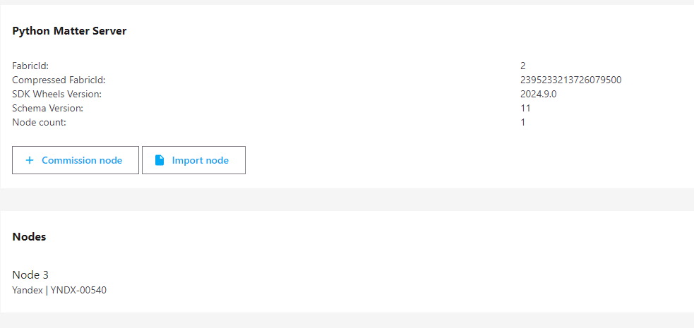

Hello, I recently got an outlet that supports Matter. It works in its own ecosystem (Yandex), and there it shows energy consumption data. Being swiped into Home Assistant or HomeKit, I can’t see the data.
But through the Python Matter Server add-on, I can see my socket, nodes, endpoints. Current, voltage, instantaneous power values. But I can’t figure out how I can throw this data into the sensors so that it goes into the statistics. Can you tell me?
Is it possible to do with Home Assistant, add-ons and integrations, or will I have to code?

Unfortunately, that’s all I see on the page is what’s in the screenshot.The values aren’t there. If there were, I could have handled it myself =)
