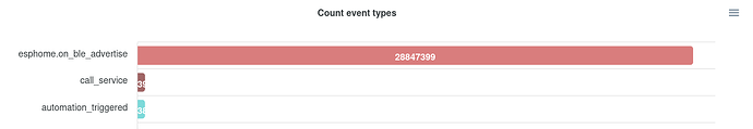

The values for ‘packet,’ ‘time_fired,’ and ‘id’ are changing rapidly, resulting in 20-30 records per second. Has anyone experienced something similar or have insights on how to address this issue?

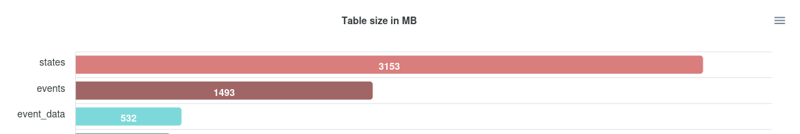

My home-assistant_v2.db database file is expanding by 1.2GB each day for this…

Look at the counts of those two events, they are still pouring like crazy into my database.
and on full-blast when I Listen to events.
