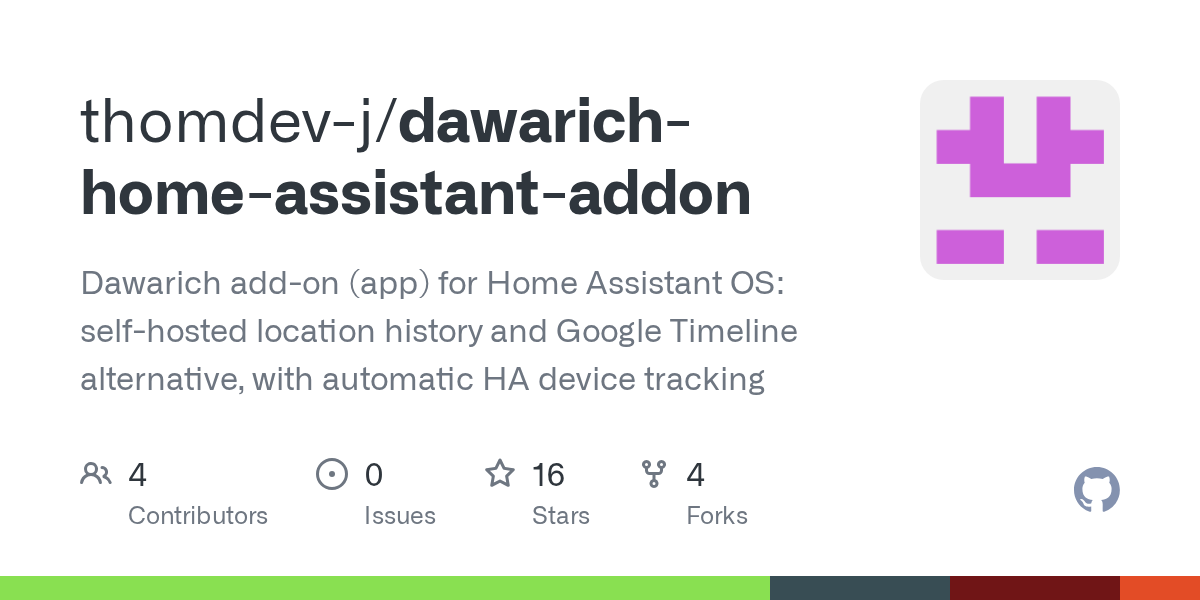

Settings → Apps → Install Apps → ⋮ → Repositories, then add:

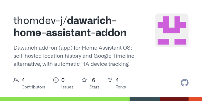

  • It is linked from Dawarich’s own docs: Home Assistant | Dawarich
