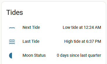

As it happens, today the moon was in its last quarter, and the automation did its job. My Tides card looked like this today:
It does look a little odd with the zero there, but I know what it means.
