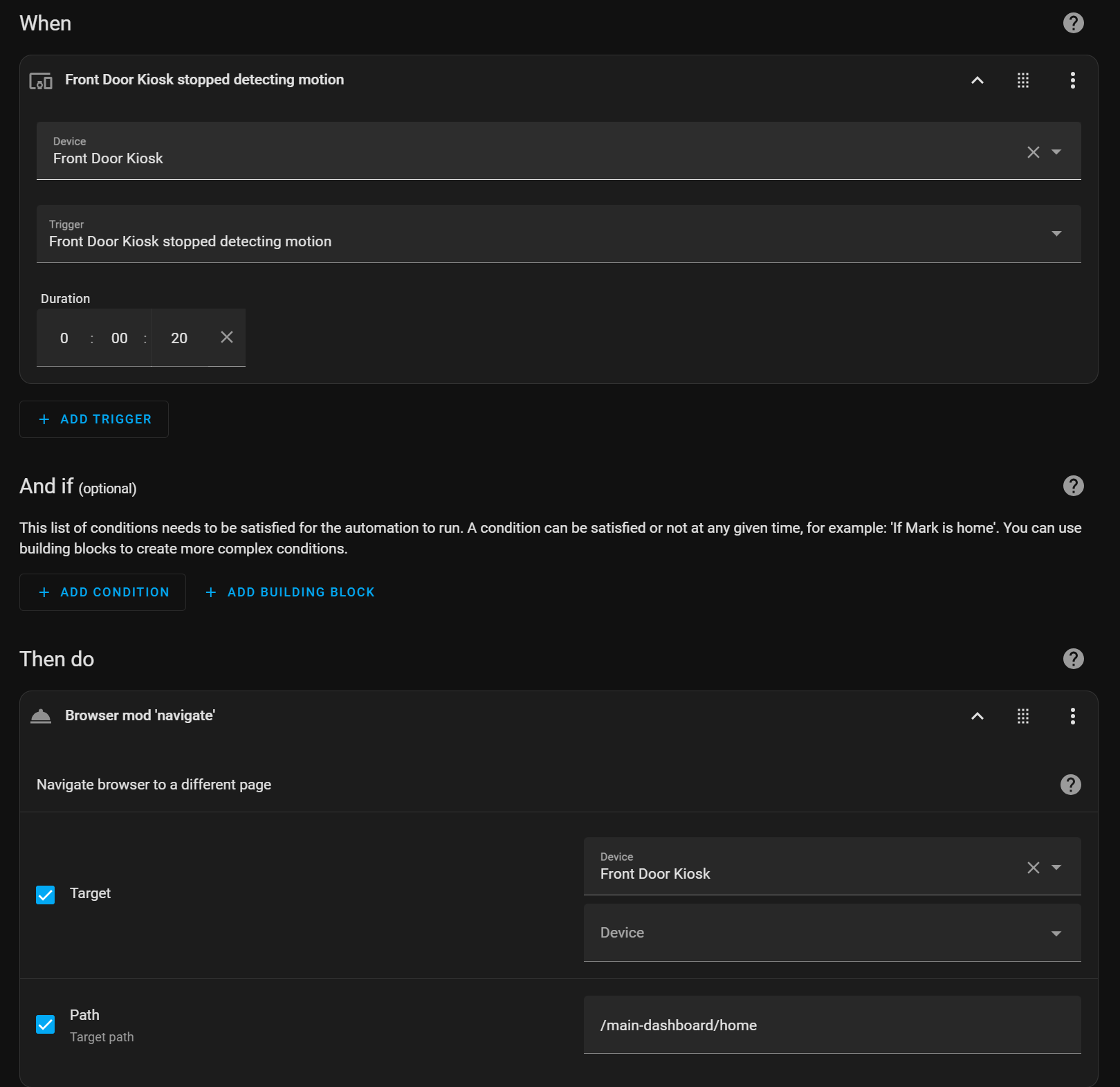

I’ve got this working nicely based on motion detection (or lack thereof).
alias: Navigate home on idle My Device
description: ""
triggers:
- type: no_motion
device_id: <myDeviceID>
entity_id: <myEntityID>
domain: binary_sensor
trigger: device
for:
hours: 0
minutes: 0
seconds: 20
conditions: []
actions:
- action: browser_mod.navigate
metadata: {}
browser_id:
- <MyDeviceID>
path: /dashboard-main/Home
mode: single
