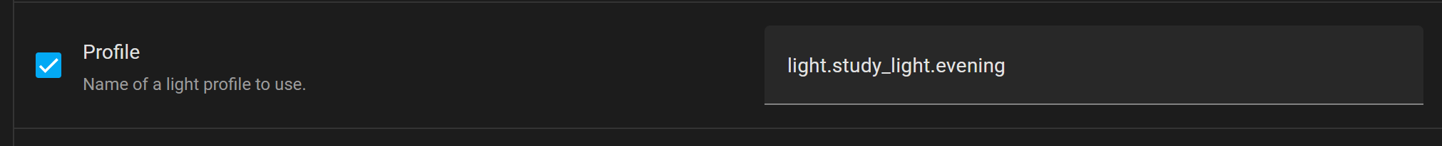

@tom_l - just coming back to this, are entries in light_profiles.csv used regardless of whether they are specified in the Advanced settings of the light_turn_on function or not?
