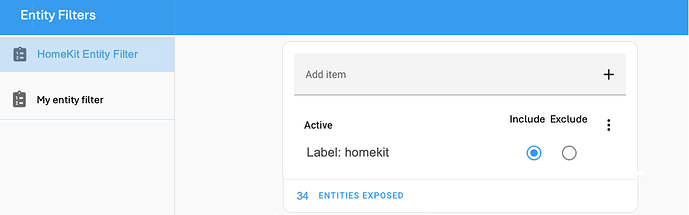

MAYBE this expansion of entity filter definitions could bring in the possibility of including areas and labels as well as the traditional filter includes (a concept which has appeared in multiple disparate feature requests). I’ve attached a VERY ROUGH concept below to convey the idea, but a split-pane that auto-refreshes the “exposed” entities would be better.
