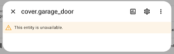

I used to have MyQ but when that imploded I got a ratgdo. Working on setting it up now, but I cannot delete the old cover.garage_door entity. I want to delete it so that the ratdgo entity can be renamed with that so any automations or alerts won’t need to get updated. Home Assistant has been restarted many times since MyQ was removed, but I still have this orphaned entity that I can’t remove. Any ideas on how to remove it when the integration itself is gone?
This seems like it’s going to be what I have to do. I’ve found other thread where people reference it. I do backups every night so if I screw something up and worst comes to worst I just nuke the entire thing and restore from backup.
Edit: Did this and it was super easy and it worked immediately!
