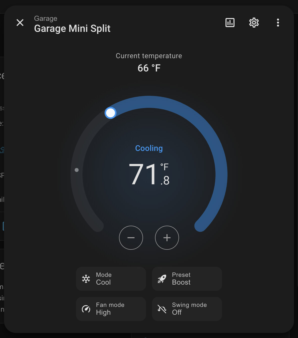

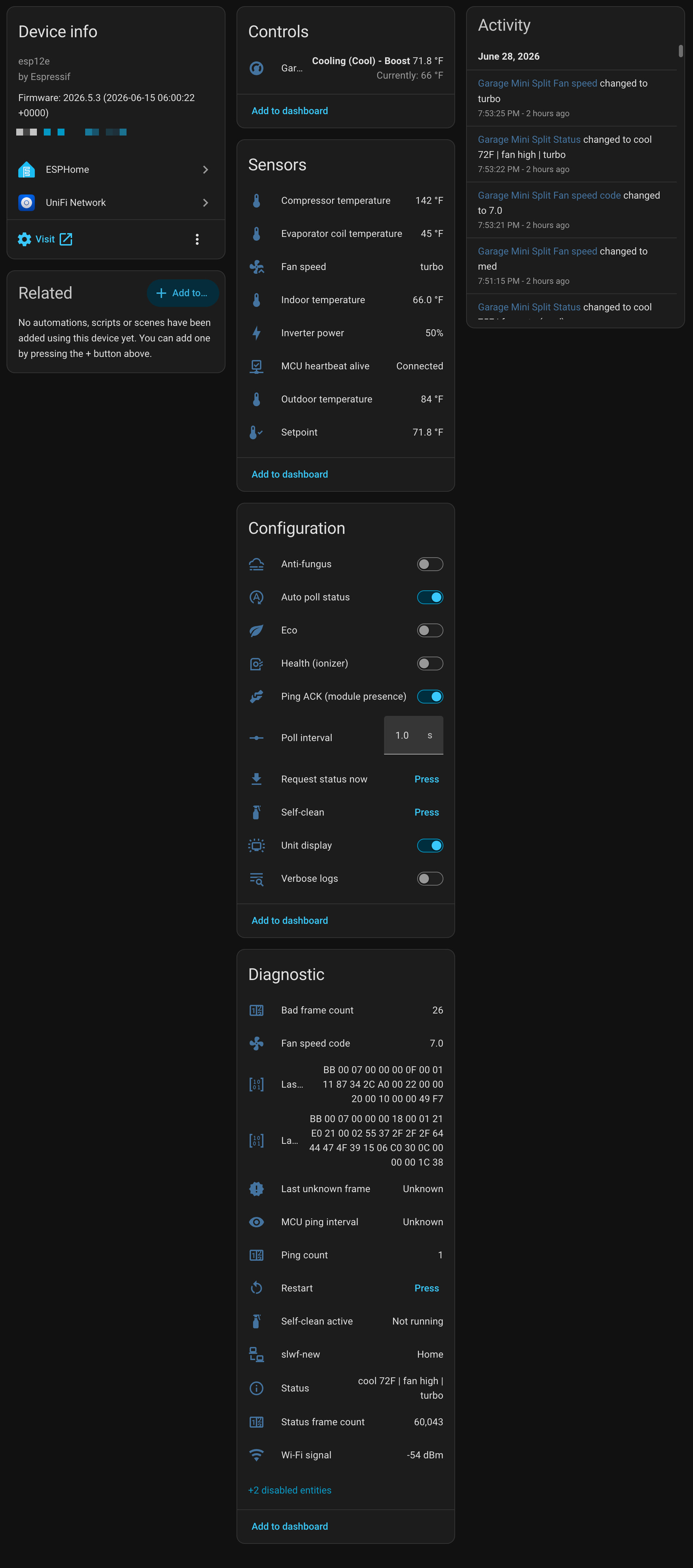

It took me a bit but I've got a stable ESPHome build now for the Della 048-MS and (soon) Della Motto 12K1VRH-20S-JA-I+O. It is 100% fully featured when compared against the button options of the YKR-H/101ER IR remote.
Check it out here: GitHub - adamgranted/esphome-della-ac: Fully featured ESPHome + SLWF-01 support for (some) Della mini splits. · GitHub
I'm open to issue submissions and new model requests -- adding additional models is straightforward so far.
