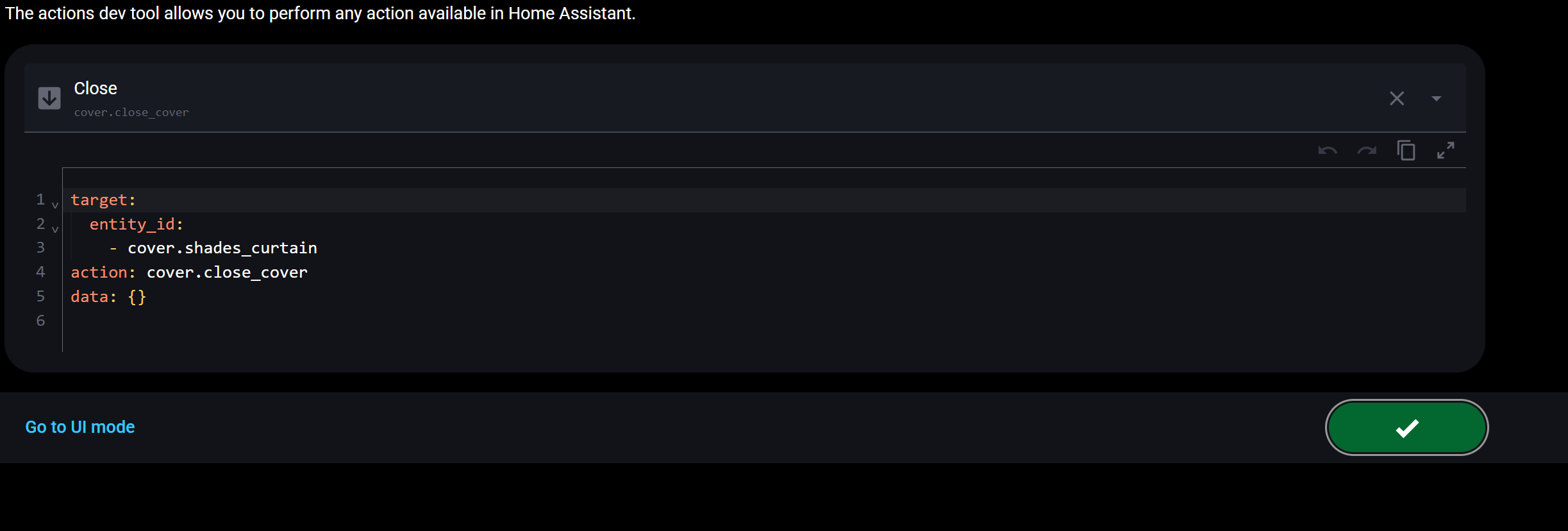

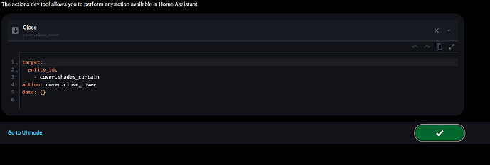

It’s a first time I used this Action and this is what I got
indenting is off now, entity id should be indented more, like in your cover. Same as what Petro showed here:
And of course you’d want to try open and close rather than stop.

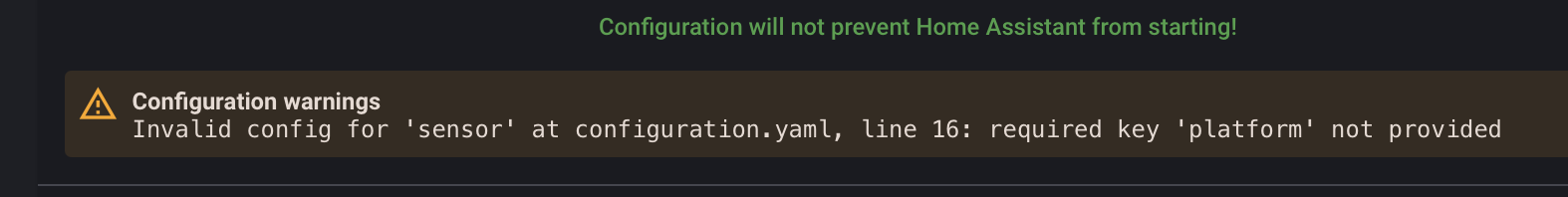

I edited the template sensor as suggested but got this error complaining about missing “platform” while the instruction told me to take that out. So what is this?
It was a wrong code maping
Yes, it’s responding to actions OPEN, CLOSE and STOP
This usually means you put the new version in the old place, under sensors. It should be under templates. If you have a templates.yaml file already the new yaml should be placed there, but with the top template: line removed and the indenting mattching what is already there.
The new configurations do not go in the sensor.yaml or binary_sensor.yaml files
They need to be placed in configuration.yaml or a properly split file under the template integration.
