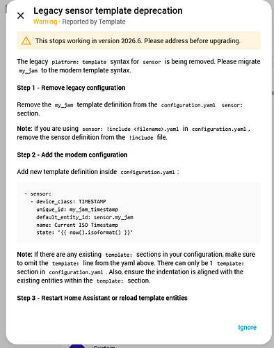

A repair will appear if you are using legacy template entities in 2025.12. The repair will offer a migration guide.
If you’re having trouble with the repair migration guide, please check out the migration guides in the documentation.
This custom integration is a migration helper if you have 100s of legacy templates. Please understand that this will generate the bare minimum migration path and it requires minor edits to configuration.yaml. The custom integration will traverse current legacy template issues and generate a series of files inside config\migrated_templates folder.
E.g. This legacy template definition:
sensor:
  - platform: template
    sensors:
      my_jam:
        friendly_name: Current ISO Timestamp
        device_class: timestamp
        unique_id: my_jam_timestamp
        value_template: "{{ now().isoformat() }}"
Will produce this repair

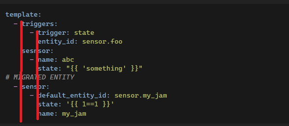

Bad migration example 2: Incorrect indentation
Also, make sure your indentation is correct.
I.e. if you have:
template:
  - triggers:
      - trigger: state
        entity_id: sensor.foo
    sensor:
      - name: abc
        state: "{{ 'something' }}"
You’d line up the migrated template entity with your current indents.
Good merge
template:
  - triggers:
      - trigger: state
    sensor:
      - name: abc
# MIGRATED ENTITY
  - sensor:
      - default_entity_id: sensor.my_jam
        state: '{{ 1==1 }}'
Bad merge
template:
  - triggers:
      - trigger: state
    sensor:
      - name: abc
# MIGRATED ENTITY
- sensor:
    state: '{{ 1==1 }}'
