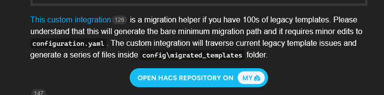

And I wrote a custom integration linked in this post that converts all issues at once for you.

It won’t lie if you box it in, tools work best when configured optimally. @petro has created a tool that will make it easier for many.
Works great! To avoid posible issues just remember to download all the yaml files and follow the steps people, perfect solution for me
Migrated all my templates fine, thanks to Petro.

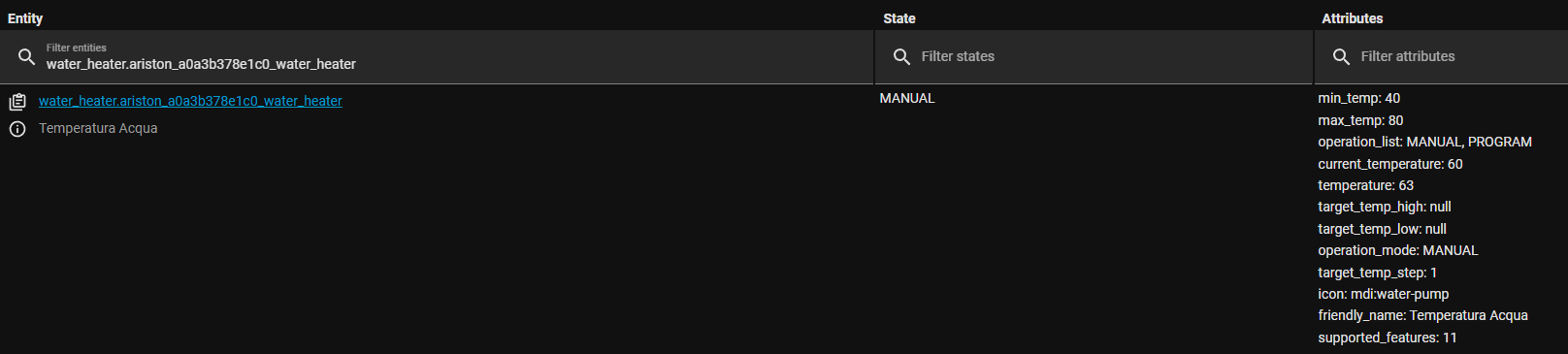

Only template from derivated (i don’t know if this is the right name) sensor like this one doesn’t work
before working template, in sensor section:
      actual_bolier_temp:
        friendly_name: "Actual Water Temperature"
        unit_of_measurement: "°C"
        device_class: temperature
#        state_class: measurement
        value_template: >
            state: {{ state_attr('water_heater.ariston_a0a3b378e1_water_heater', 'current_temperature') | float(0)}}
migrated yaml, suggested from HA:
  - unit_of_measurement: °C
    default_entity_id: sensor.actual_bolier_temp
    name: Actual Water Temperature
    state: 'state: {{ state_attr(''water_heater.ariston_a0a3b378e1_water_heater'',
      ''current_temperature'') | float(0)}}'
this show unavailable as state
You have state twice… that leads to the state value being non-numeric, which isn’t allowed for entities with a defined unit of measurement.
corrected as follow:
    state: "{{ \n state_attr('water_heater.ariston_a0a3b378e1_water_heater',
      'current_temperature') | float(0)}}"
doesn’t works anyway…
Why did you add a new line mark inside the expression?
Also, the float isn’t doing anything, so there’s no reason to keep it:
    state: |
      {{ state_attr('water_heater.ariston_a0a3b378e1_water_heater', 'current_temperature') }}
