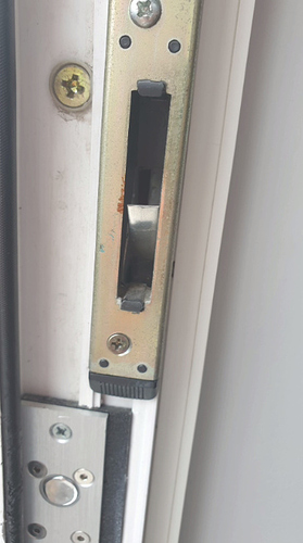

how does the door lock into the frame?
I have fitted a micro switch into the keep on the frame where one of the bolts enters the frame.
Unfortunately that won’t work for my doors - they are all multipoint locks, so there are hooks which go into the door frame when you lift the door handle, then you can turn the key to stop the door handle being pushed down to pull the hooks back into the door.
The handle can be lifted and the hooks set into the frame without needing to turn the key (which effectively means the door isn’t locked… since it’ll open if anyone presses down on the handle).
