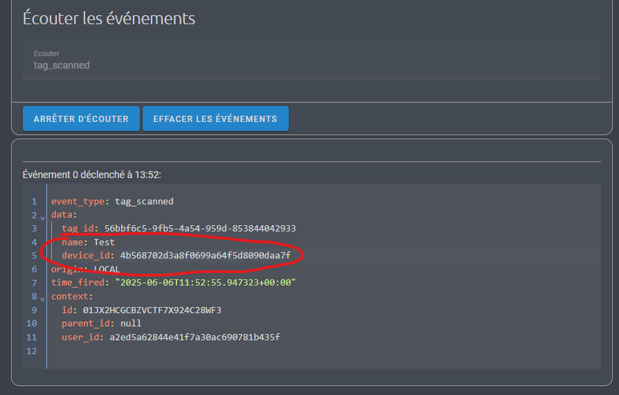

You have the device id of the mobile app in the tag scanning event
and you can send a notification by device id:
            - device_id: !input notify_device
              domain: mobile_app
              type: notify
Now, if you’re complaining that it’s not out-of-the-box, I agree, but you definitely don’t have to hack HA to achieve this.

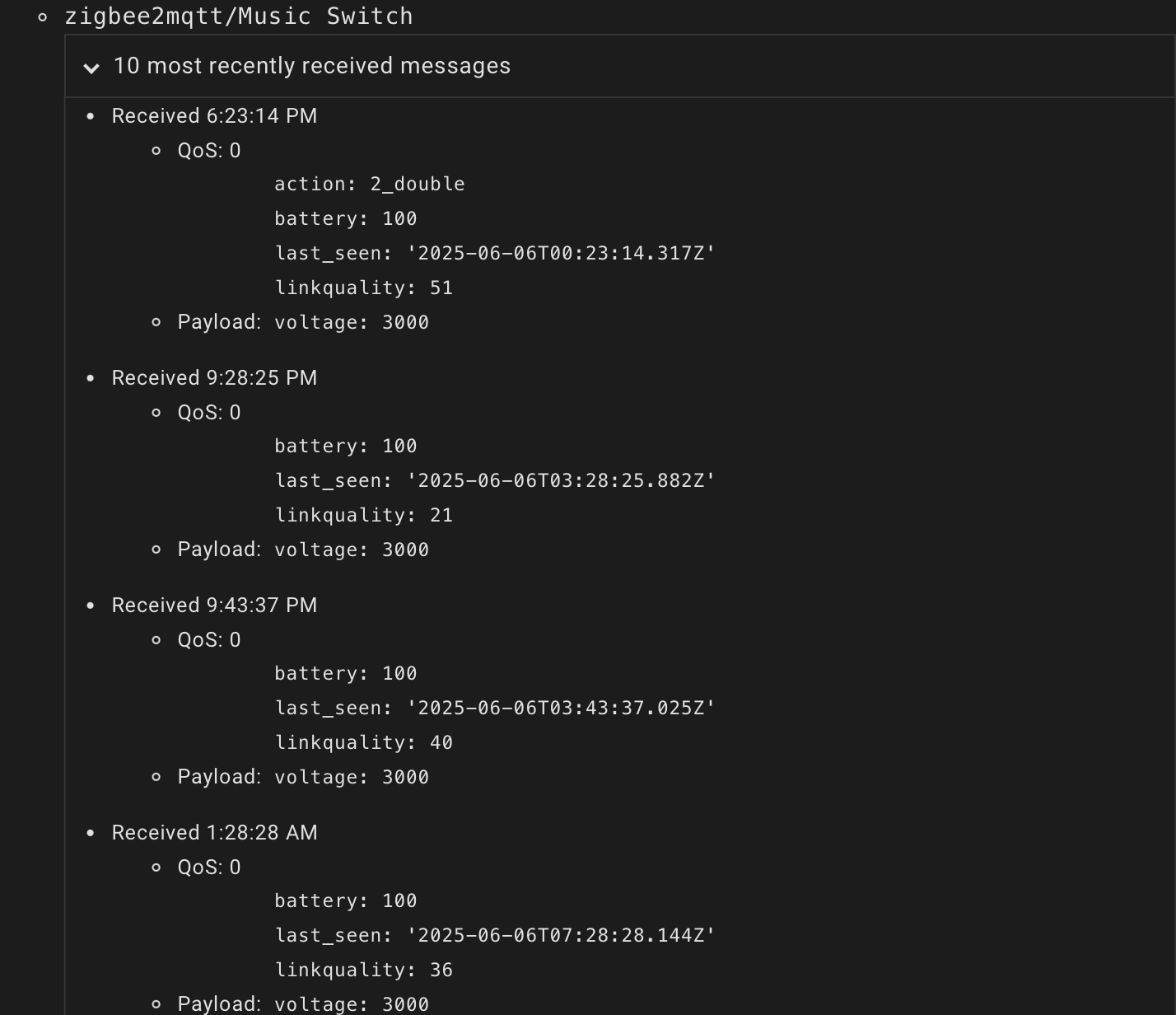

If you see the button pressed in MQTT Explorer, how difficult can it be to add that to a MQTT trigger ?
Yes, z2m is a fantastic piece of software and has been very reliable for me. Thank you so much. I didn’t mean to imply it was the source of the issue, I was only laying out the steps I had taken to debug it as a means of illustrating the absolute insanity it can be to debug HA sometimes. I was frustrated and I probably shouldn’t have posted it here. I apologize if you or anyone else feels it was criticism directed at them. HA is an ecosystem and it is what it is. I’m grateful for it. And grateful for your help.
I got to the point of “everything looks good up until HA, and now HA should be taking this MQTT message and firing an event when the button is pressed”. But I’m just not seeing any event, which is what brought me to this thread.
I got a little frustrated seeing OP asking for help only to be told “well it works for me, you must be doing something wrong”. I have worked in tech for 20 years and I know users often ARE doing something wrong. But good tools will make it easy to do the right thing, and great tools will make it impossible (go ahead try to break the software on an iPhone). Anyway that’s beside the point and not worth spending another moment on.

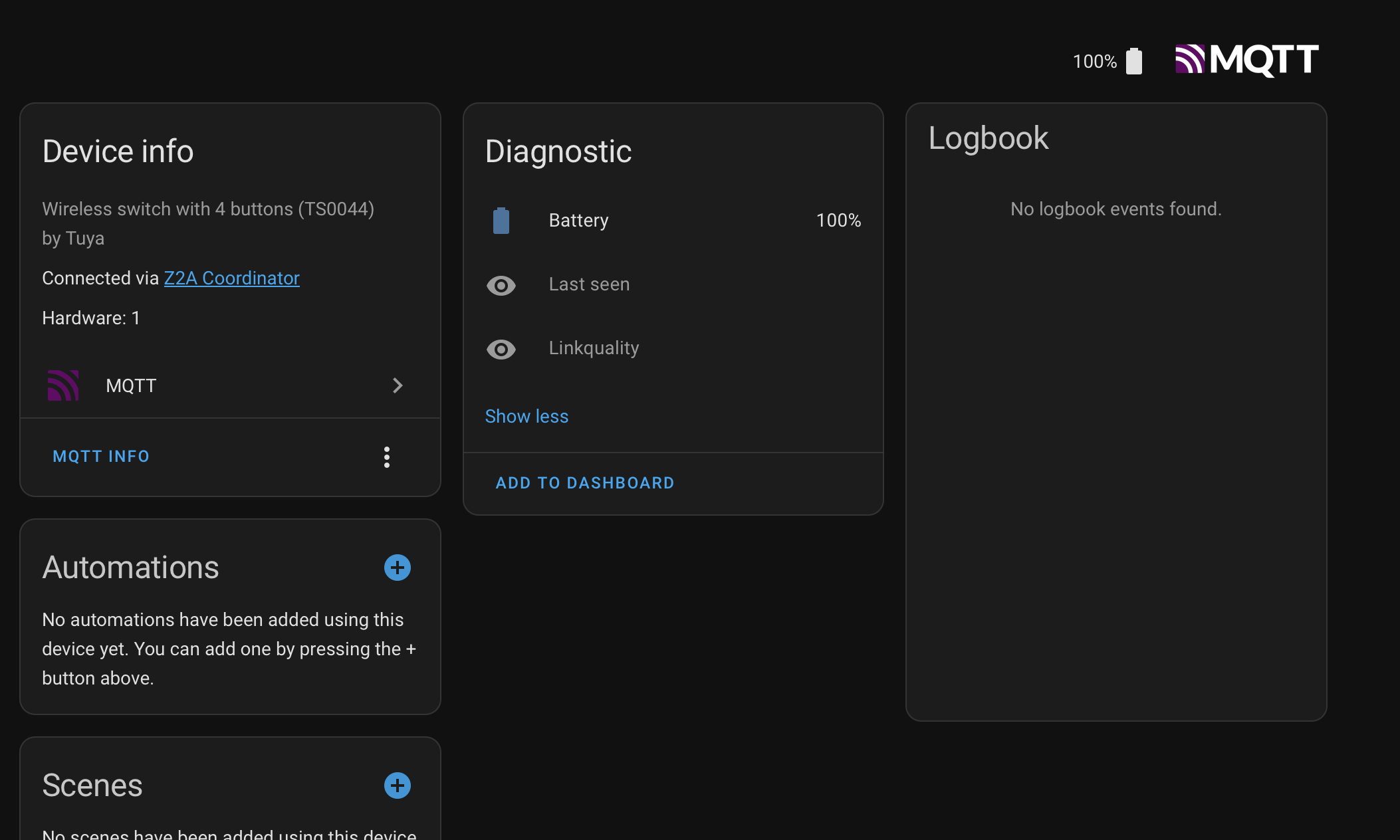

As to my event, it’s no where to be found. It’s obviously not in the ‘events’ tab on the developer tools. I have the Jupyter Labs add-on set up with the Pyscript kernel which allows me to autocomplete entities. Here is what I’ve got for events in there (it’s none of these):
I have a Pyscript automation set up to dump my entities into text files on restart (so I can use them with AI coding tools), what I see there matches what I’m seeing in Pyscript.
The only entity I’m seeing for the switch is ‘sensor.music_switch_battery’. But it’s not clear to me whether the button events would show up as an ‘entity’ anyway (from what I understand they should be an ‘event entity’ but I could be mistaken).
Here’s the result of searching my entity files for the name of the switch (it’s ‘music_switch’):

Here is some possibly relevant info:
Don’t feel obligated to dig in or anything but maybe you have an idea of what to try next. I do have a 2nd switch of the same type so maybe I’ll try that one and see if I have better luck.
This was the critical missing piece! Everything in the docs made it sound like I needed the entity id for the notifier (and silly me didn’t even try the device id)! Hallelujah!
Hacking was maybe a bit hyperbolic, but there is no built in way to translate the device id to an entity id which is the crux of the issue in this case.
