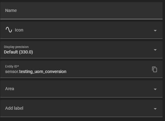

Although we defined unique_id - Uom cannot be changed, no such a field:
So we have to change UoM in yaml:
