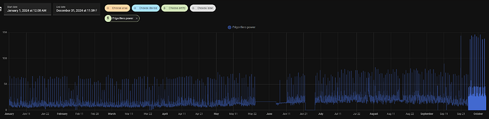

Do you somehow handle when you move the thing, but want to preserve the history in the original location?
Let’s say I have electric plug with consumption meter. It’s called livingroom_plug_consumption. I buy a new one, the old one died or I will move it to different location for some reason. But all the history, accumulated history will stay with the device, not identificator. So it will look like that my lamp had high consumption a week ago, because it was in kitchen powering a fridge.
A can only think about creating a helper as an alias for the entity, but that will be hard to maintain and will end up with so many values.
Did you try to achieve something similar or don’t care about that?
If a device breaks, I just change it and my log remains.
Here you can see the log data of my fridge with the device that broke in June.
