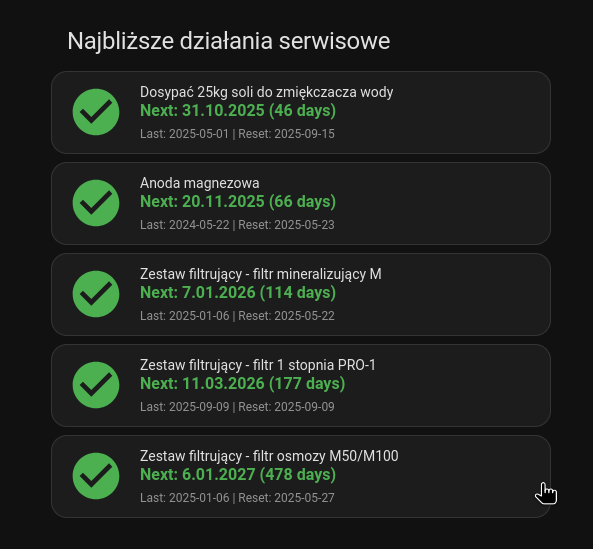

If anyone interested, I’ve used it to track may bigger house chores. It uses auto-entities to display it with some custom button card, that add day counting and coloring (green >10 days, yellow <10 days, red<1 day) depending on chore timeout. Also when pressed, it opens more-info for binary sensor that’s allow to reset the task.
type: custom:auto-entities
filter:
  include:
    - integration: device_maintenance_monitor
      domain: binary_sensor
      options:
        type: custom:button-card
        template: card_device_maintenance
        variables:
          card_force_background_color: true
  exclude: []
sort:
  method: attribute
  attribute: predicted_maintenance_date
card:
  type: vertical-stack
  title: Najbliższe działania serwisowe
card_param: cards
grid_options:
  columns: full
  rows: auto
And the custom button card - you need to put it on top of the dashboard yaml config with Raw Configuration Editor:
