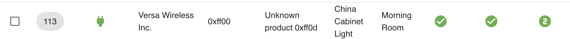

In this case, I am trying to add a Zoos ZEN04 smart switch. I’ve added a few others in the past without incident, but this time, even after exclusion and a second attempt at inclusion, it’s listing itself as an unknown product. Some of the configuration options are different than they should be.
I’m including screenshots of what it looks like and what it should look like based on a successful inclusion of an idential product.

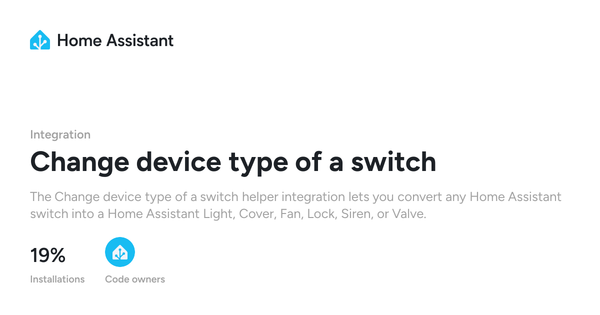

There is a helper that will change your switch into a light if that is what you are asking.

It’s definitely a Zoos ZEN04 smart switch. I’ve now excluded, factory reset, and then included several times, all with the same result. It shows up as an unknown device as shown in the screenshot in my original post.
Sounds like something is going wrong in the Interview process. If it were me I’d re-interview an existing working ZEN04 and then this device and compare the logs between the two.

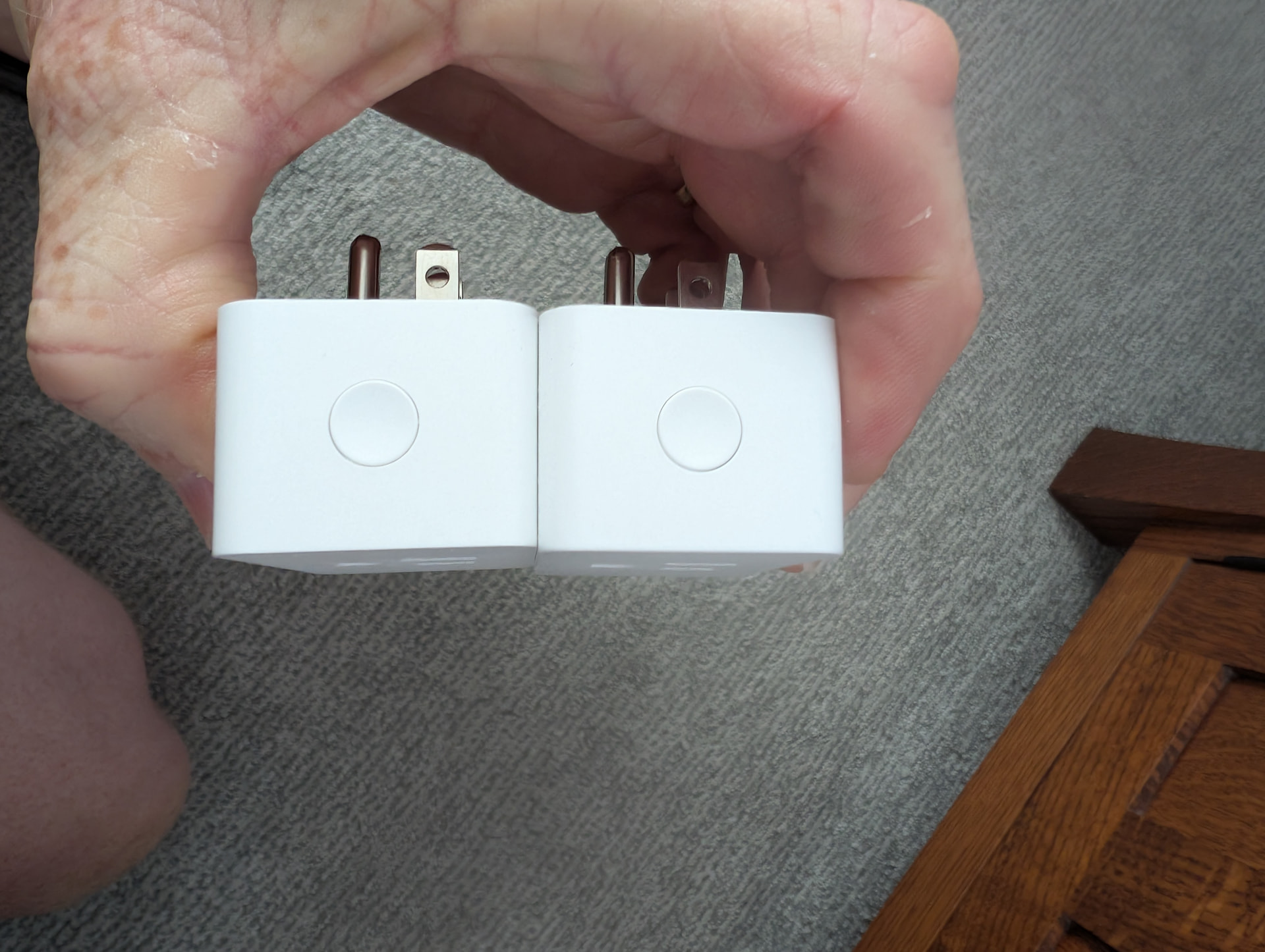

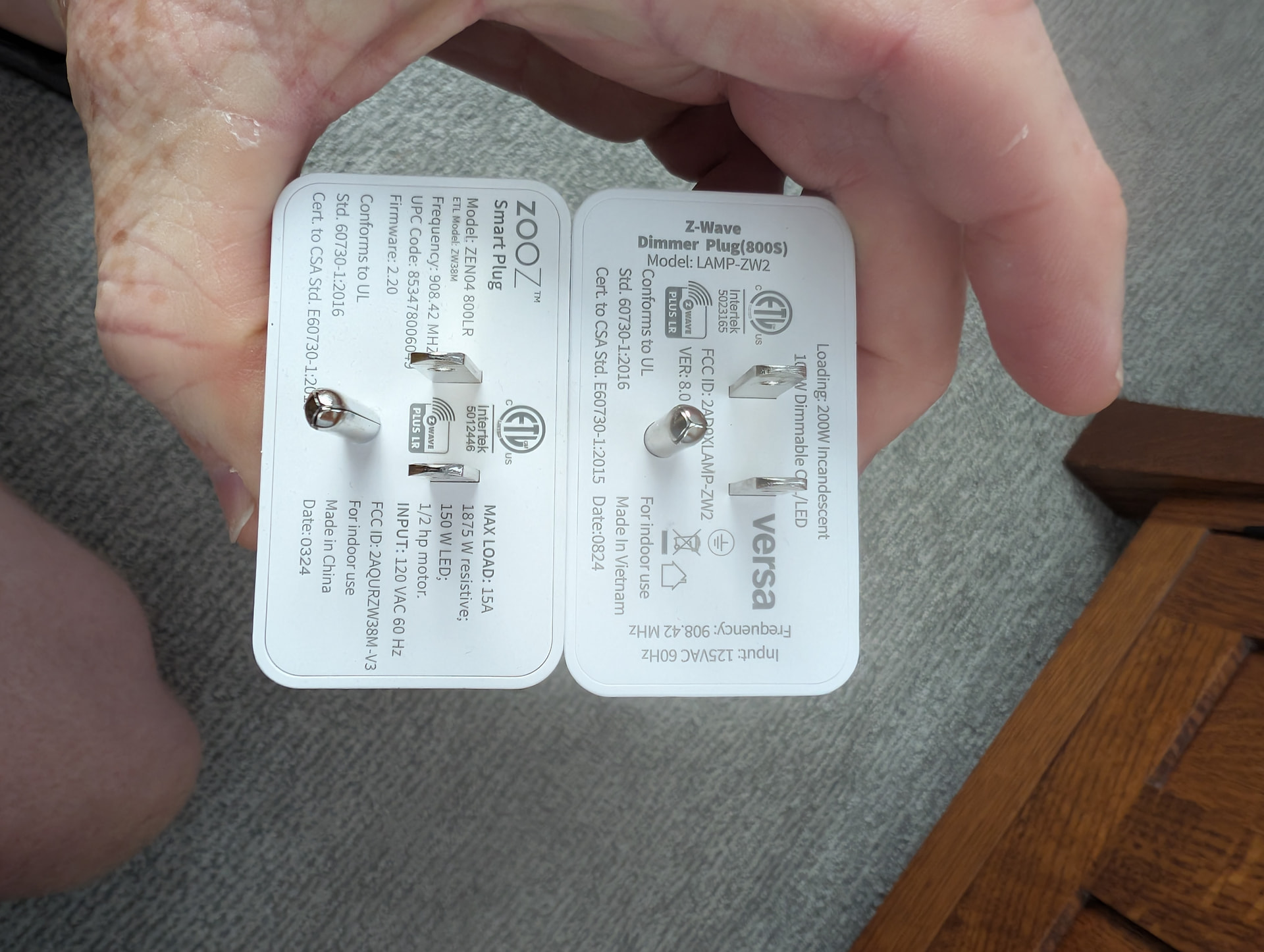

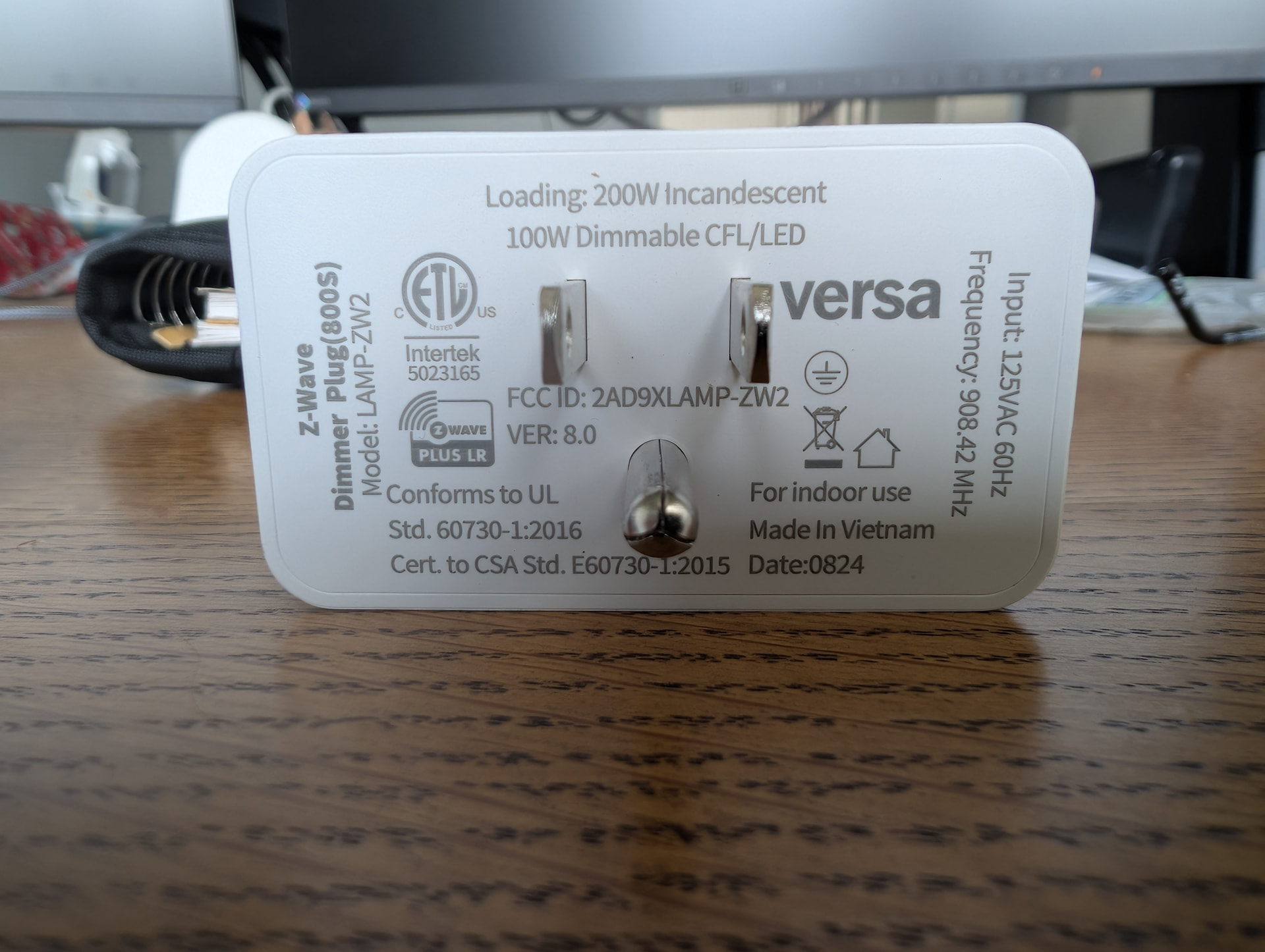

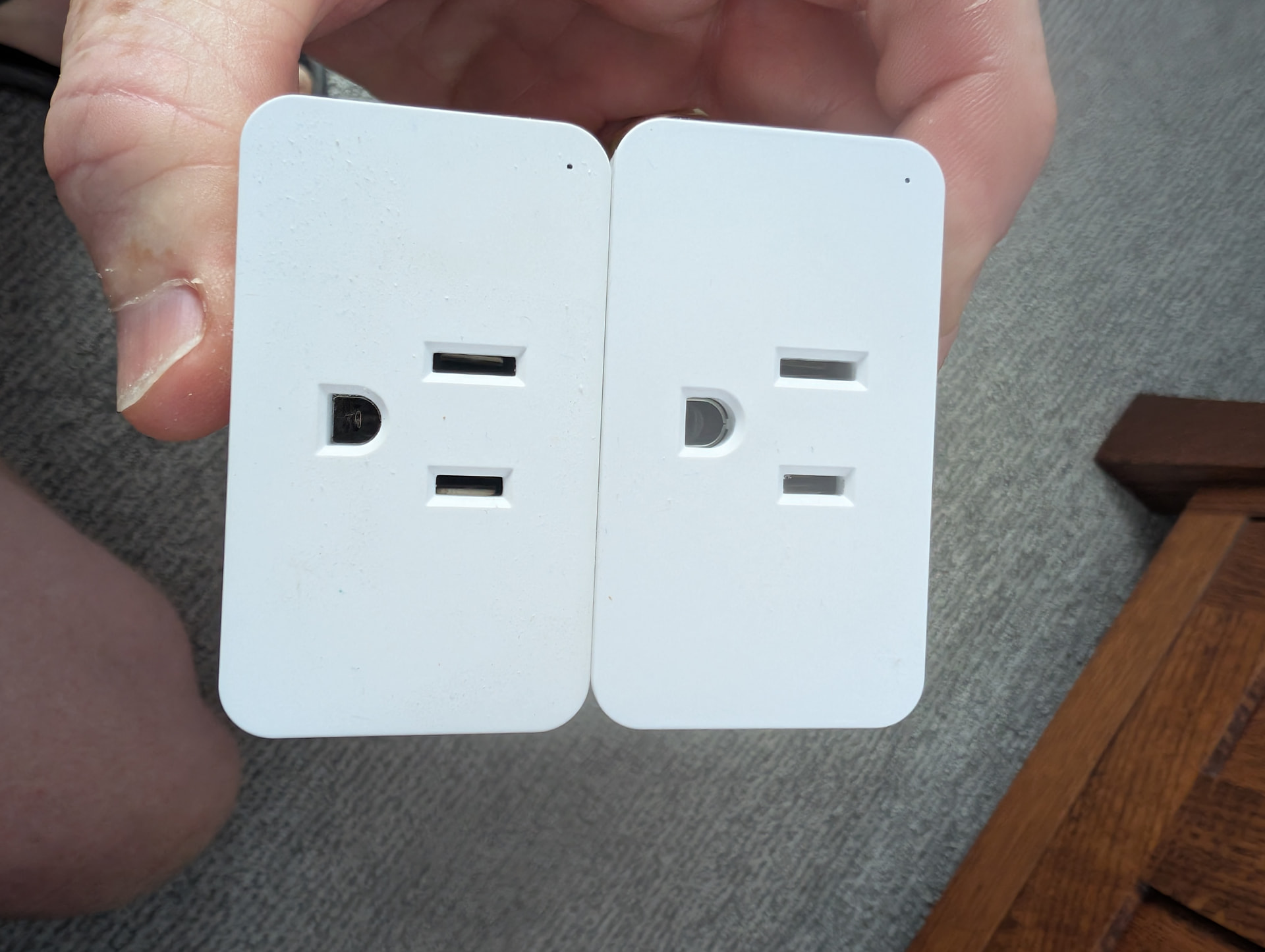

UPDATE: Well this has become quite interesting. I reached out to Zooz and described the issue. They asked for a picture of the front and back of the errant device. I took those pics and the light bulb went off. The back of my device, which I took out of a Zooz ZEN04 box yesterday, is labeled as a Versa LAMP ZW2, a dimmable lamp plug. I checked one of my other ZEN04s and it is branded as Zooz.

This is not a ZEN04 device; it is a Versa device and is being identified correctly by Home Assistant. While it looks just like our ZEN04, our devices are labeled with our Zooz logo and device information on the back.
Please let us know if you have any questions going forward!"
I replied it was very odd that the 5-digit DSK Pin on the Zooz box and the Versa device were the same.
She then asked for me to exclude and include the device again so I could capture the complete DSK on the Versa device. It matches the printed label on the Zooz box exactly.

It does. I based my original comment on the fact that I opened a factory-sealed Zooz box labeled as and containing a device that from the front and sides looks identical to a ZEN04 and also contained an instruction sheet for the ZEN04.
I confess that I did not turn the device over and note that it was something different than was in the box.
