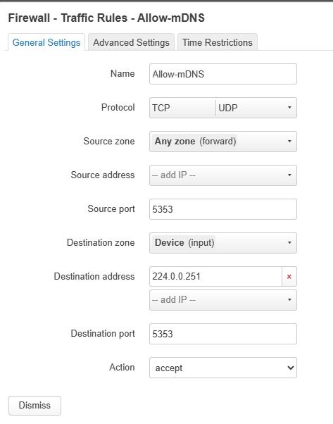

Updated solution, as I couldn’t restore my system after a failure.
On the secondary router -
  1. Install the avahi-dbus-daemon.
  2. Modify the config file /etc/avahi/avahi-daemon.conf with Reflector=yes (you can install nano to make this easier - you may also need to enable SSH)
  3. Create a Firewall Traffic Rule as follows:
Restart routers.
