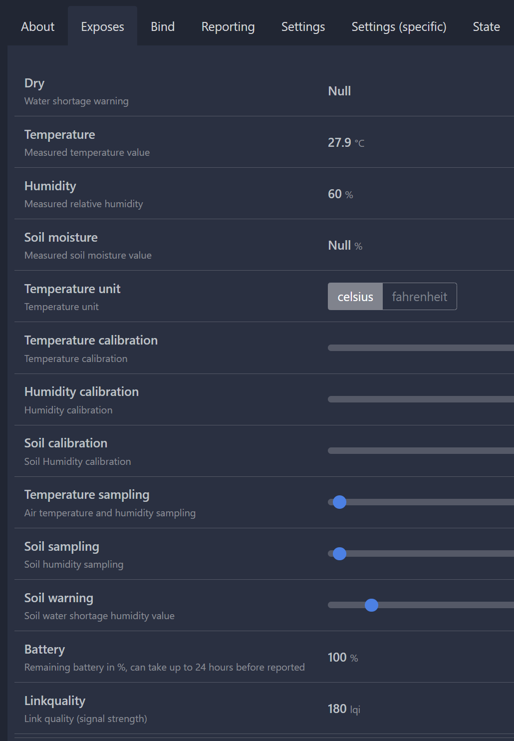

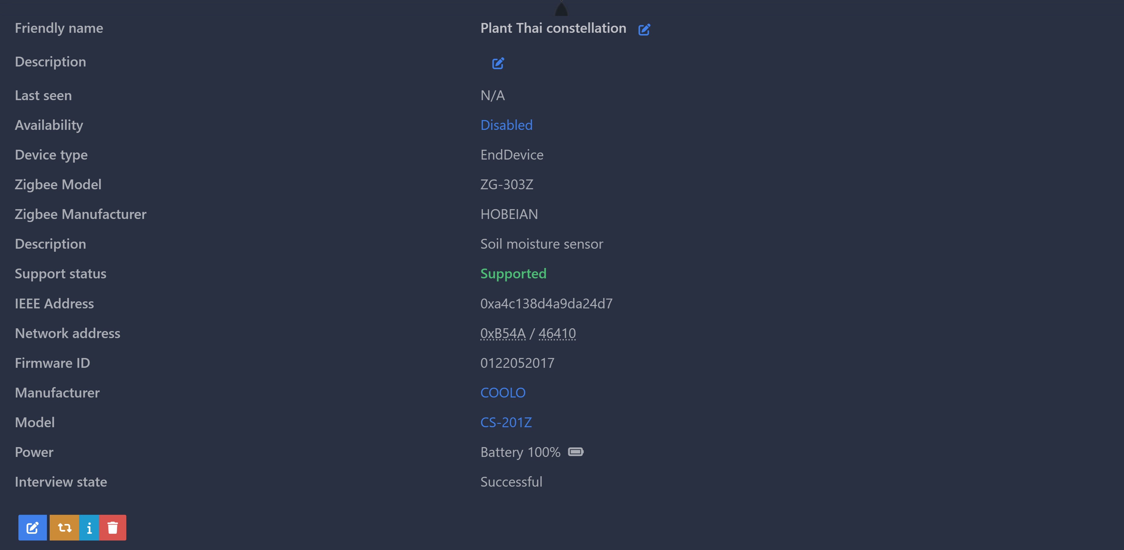

Hi, I bought and paired this device https://es.aliexpress.com/item/1005009010973629.html?pdp_npi=4%40dis!CLP!CLP%2020%2C856!CLP%2010%2C428!!!153.10!76.55!%402103085b17521824566085953e9cce!12000047572491105!sh!CL!0!X&spm=a2g0o.store_pc_home.allitems_choice_2004510104666.1005009010973629&gatewayAdapt=glo2esp the zigbee 3.0 version, not tuya, but its recognized as HOBEIAN ZG-303Z which has 2 “legs” instead of 1. Its more similar to this one COOLO CS-201Z control via MQTT | Zigbee2MQTT
It shows temp, which seems fine, humidity thats always 0, battery which is always 100%.

Edit: had the idea to update z2m and its recognized now, but the moisture value is null also humidity is 0% and battery is still at 100%
Edit2: humidity started reporting, but its at 86% which is imposible, also moisture is N/A now.
I have just bought four of these and having the same issues. Any updates on this?
Same here! :_(
I got those to check the soil moisture and its the only thing that isn’t working , ouch
