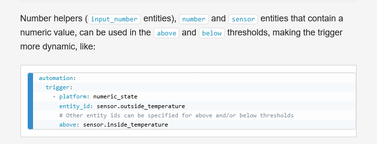

You probably want a numeric state trigger.
Can you explain in detail? Thanks!
https://www.home-assistant.io/docs/automation/trigger/#numeric-state-trigger

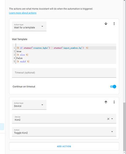

Could you write the following:
{% if states('counter.hghc') > states('input_number.hg')  %}
true
{% else %}
false
{% endif %}

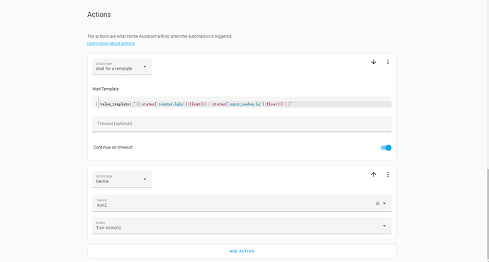

Like this:
value_template: "{{ states('counter.hghc')|float(0) > states('input_number.hg')|float(0) }}"
This will return true when the counter is greater than the input number, triggering the automation.

Is this how it is used?
English only please. Also that is a wait template, not a trigger template.

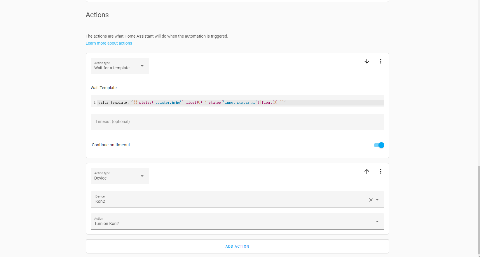

As per the example, it does not execute. Maybe my settings are wrong?
Also you don’t include the “value_template” part or the quotes if using the UI editor. Just this:
:pray:thank you very much! The execution was successful this time. :+1:
