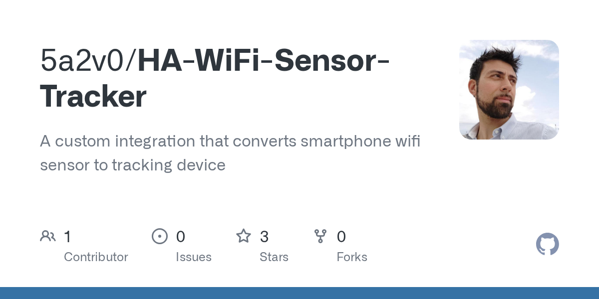

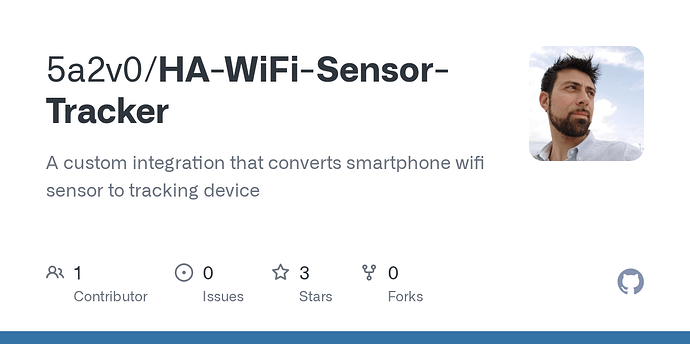

Hi, i’m working on a custom integration that creates a device tracker for each WiFi sensor selected during configuration.
Here Is the link on GitHub:
Please test it and feel free to let me know how It works for you!
Installed. I’ll test it for a while and let you know. So far it works, when I turn off the wifi it detects not at home and when I turn it back on it switches to home within a few seconds.
