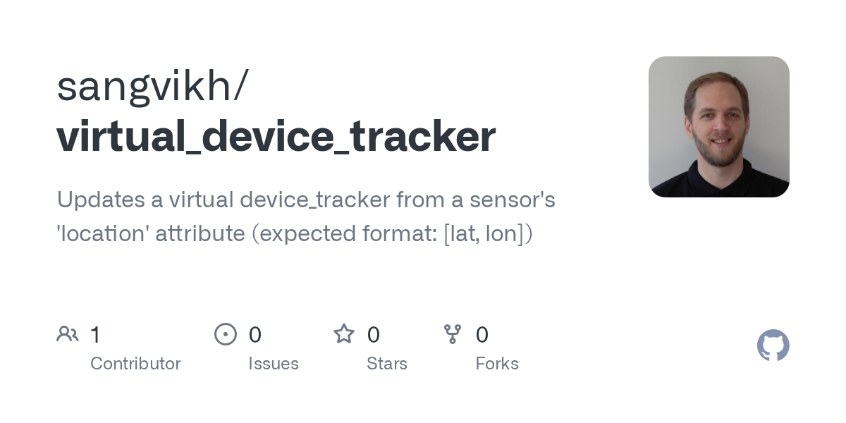

The minimal companion app does not have a working device_tracker, so i made a “virtual device tracker”, that uses the GPS data from the geocoded location. A slight limitation is that the created sensor is missing unique_id, so it is hard to manage in the UI.
Blueprint can be found here:
