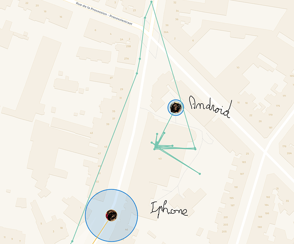

I use the companion app to “track” the location of my childs, and what I see since 2 of my chillds passed from Android phone to apple phone, is that the ones with Apple do have much LESS Frequancy update than the Android one :
As I recently configured the companion app on the iphones, it could be that I essed a kind of “update frequency” parameter somewhere, but I can not find it anywhere.
Is that a limitation on the companion app for Iphone, or something I am missing here ?
I am still annoyed with the Iphone with companion app installed where the update of the position is not as frequent as the updates for Android with Companion app.
I am still missing if this is a limitation of the companion app, or something else

Home Assistant is dependent on IOS to give it control in the background, and is usually not as generous with that as android is. Some apps use tricks to get more background time. One of those tricks is to ask for permission to track health data such as steps, which requires more frequent measurements.
So what you could try is enable those sensors too, and grant the permissions for it. Maybe it will give the companion app more background time.
