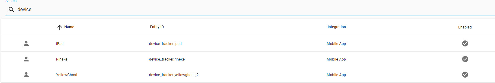

I’ve reset the IOS app and before reconnecting Ive removed all Mobile App integrations in Ha. Then I connected the app to HA again.
In HA I now see 1 entity called device_tracker.yellowghost. When I use that entity for a badge and click on it I see this:
However, location is not updated, I’ve had this configured for a few hours now and moved between few zones during that time. Location is still set to ‘home’.
