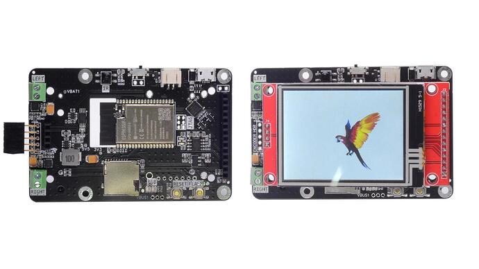

If you’re feeling adventurous, there is this little board. You’re most likely on your own though.

Thanks for the ideas! I may see about doing a pi and maybe something like a ReSpeaker Mic Array.
