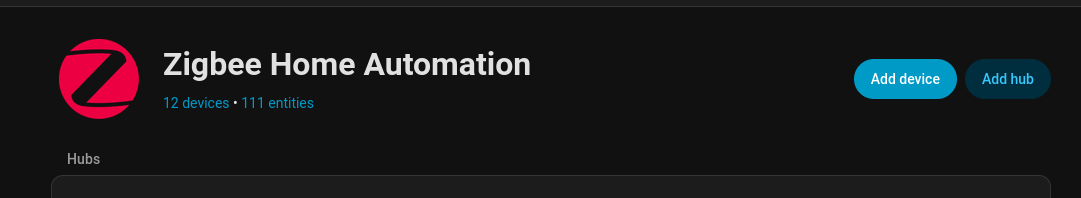

Did you go here?
Open your Home Assistant instance and show an integration.
Yes, I’m using ZHA. I’ve tried adding new devices through the add device button as well as going to an existing device and clicking “Add device through this device”.
Neither method will find any new devices, except if I move it in reach of the ZBT-2. After a device has been included into the network, it seems to work as expected.
