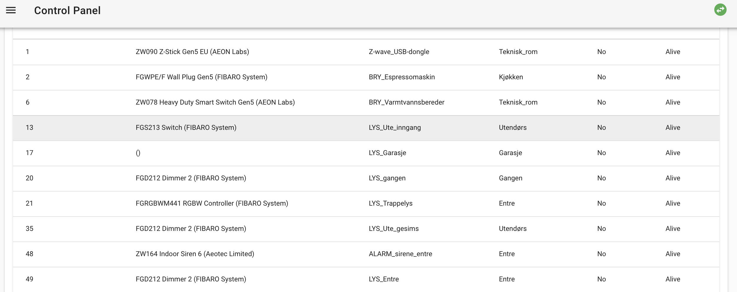

I have set up Z-wave2MQTT, following these great steps by @joselito1 and the integration seems to work as expected. All nodes show up, and they report back (as per the logs).

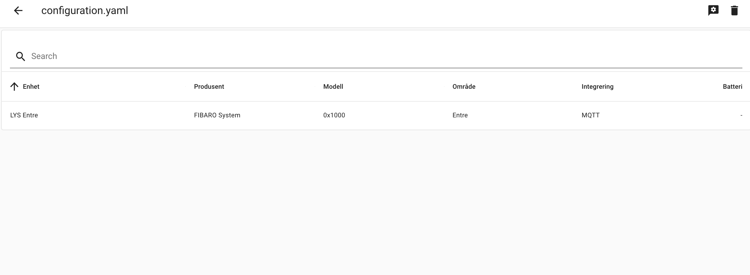

Somehow the nodes don’t come through to Home Assistant, at least they don’t show up in the integration.
This one node is hard wired, but it´s not the only Node being hard wired. In the Z-Wave2MQTT list none of the nodes run on battery. I therefore would expect the nodes to show up on the Integrations page.

I have tried to reinstall the broker, which includes removing the MQTT integration from HASS. I have activated the MQTT integration without the configuration.yaml settings, which triggered the Activate MQTT I the Integrations page in HASS. Switching back to use the settings from the configuration.yaml.
Still no show-up in HASS.
