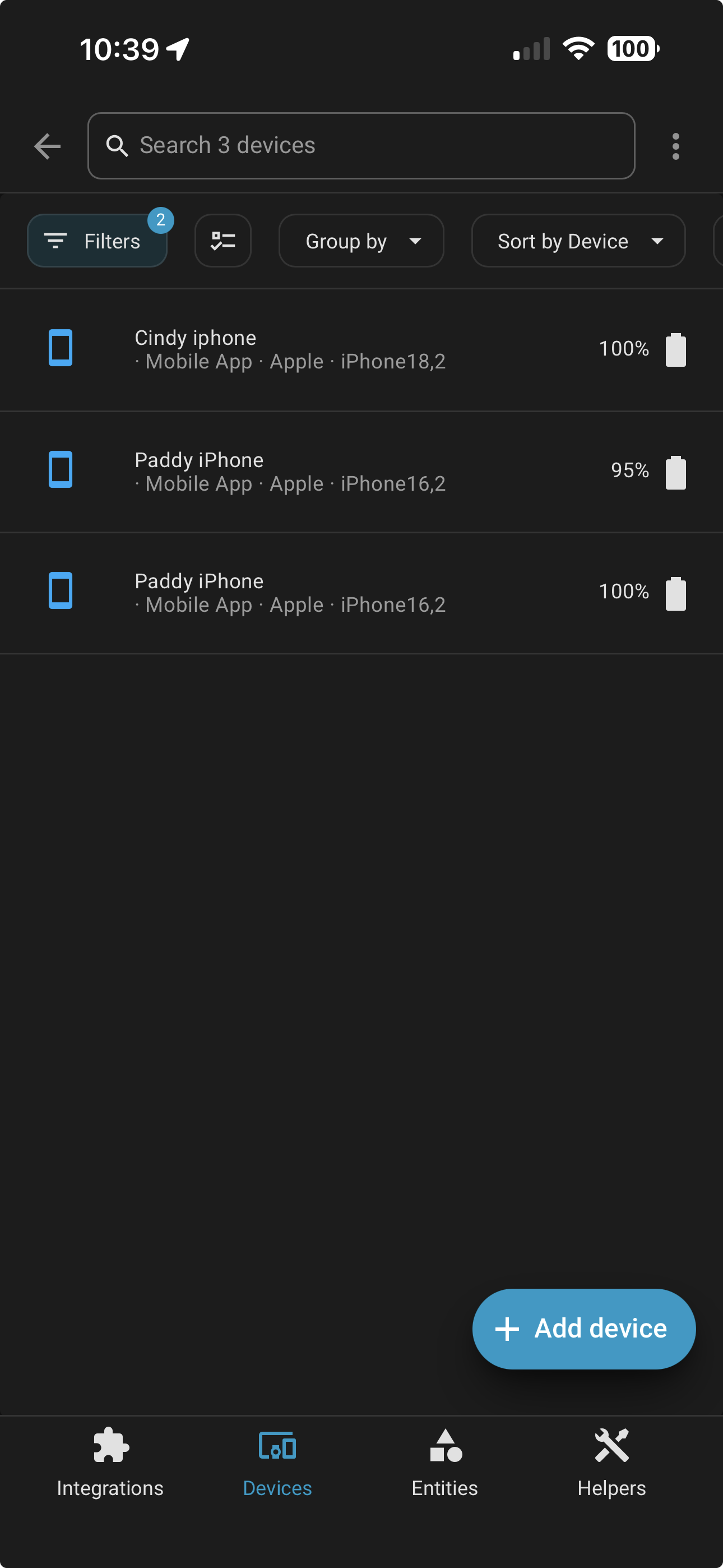

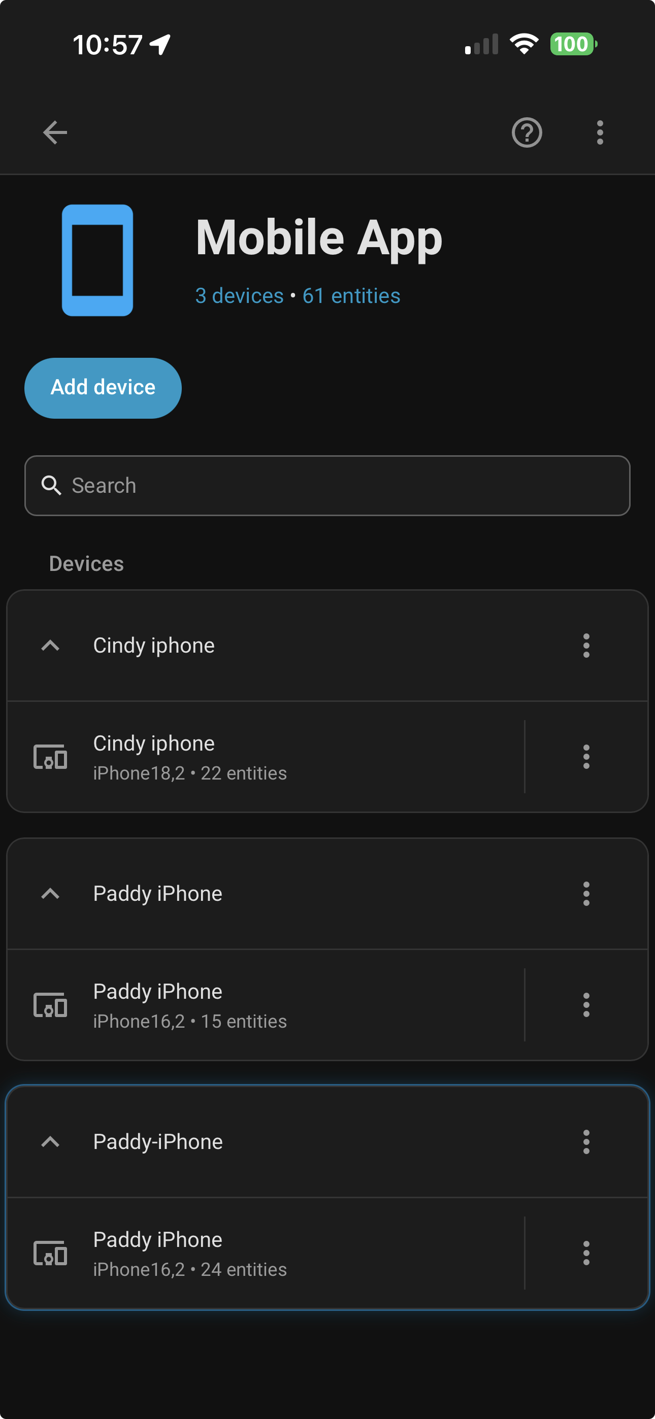

Since the login bug, when I logged out of my iphone and logged back in it created a second device. Both have to be there or location breaks if I disable one. The Notifier works on one but it doesn’t have the Geocoded Location sensor. The other has the Geocoded Location sensor but the Notifier says Unknown.
The one with the Notifier that works battery level says 95% which is wrong, it’s 100%. One has more entities and they are reporting very different information. I have an Apple Watch.
Any suggestions on what is going on or if I need to do anything to fix it? Cindy’s device only has one entry. If I delete the Home Assistant app from my phone, would that resolve it?
I had to delete the trackers and then reconfigure it again so it’s all fixed
