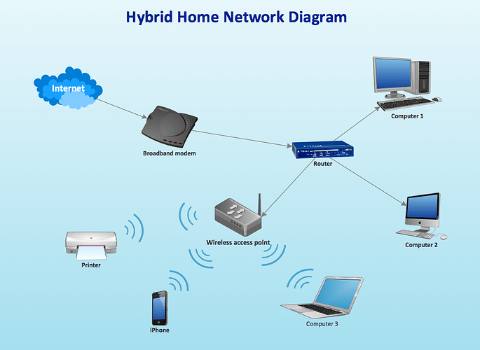

To simplify by showing it visualized:
This picture suggests using 1 wireless router/access point. Maybe that’s my problem, that I have 3 wireless routers
As for a home network I really see no reason to have 3 routers.
The Asus AXE-16000 might be the most potent of them all. Hence I would configure it as the router behind the ISP modem and disconnect the other 2 routers from your LAN. According to its specs the AXE can do all what you are trying to accomplish (considering that all of the three routers are within 5 meters of each other anyway).
The above should be more than sufficient for a small home network. No additional routers needed.
Referring to the above picture “Router” and “Wireless access point” will be one device only (your Asus router).
  • Switch OFF the WiFi of the Huawei modem and connect the Asus WAN port to one of the LAN ports of the Huawei modem.
  • Now just configure your Asus to connect to the internet using the Huawei modem as the internet gateway.
If you get this successfully done I (or somebody else here) will guide you through the optimization to get the max. bandwith out of your network.
