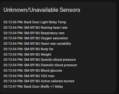

I have some “maintenance” dashboards that let me view state of such things, such as battery monitoring (I can see the pbattery status of everything on one dashboard, so it’s easy peasy to see which devices I should sometime put new batteries into). One of these are the sensors that are offline or unavailable that should be available. It sorts the list of sensors by the time they became unavailable. There are some sensors that you would expect to be unavailable sometimes, like your phone when it is turned off, battery status of your car when it is not at home is another example, etc. etc. I have an older smartwatch that does not reports some of the stats that re shown in one mof my integrations, so those are shown in my card below that I have not gotten around to rectifying (because I am getting a new smartwatch soon). So, some of those that you don’t want to monitor at all you can exlude in the settings for this card (currently also I have disabled the back door lisght switch relay in HA as I am replacing the fixture right now)… I also wanted a card that takes up as little space as possible (so in that case I don’t want an auto-entity card as each line takes up alot of space, but use a markdown card instead) -
So, here is what mine looks like (dynamically populated realtime with only the sensors that are unavailable or offline):
And here is the ralated code:
type: markdown
title: Unknown/Unavailable Sensors
content: >
  {% set sensor_issues = states
     | selectattr('state', 'in', ['unknown','unavailable'])
     | rejectattr('entity_id', 'match', 'device_tracker.')
     | rejectattr('name', 'search', 'S23|current|Amarmfob|Reconnect|Reboot|Repairs|Reload|Restart|Alexa|holding|Estate|Room|Vibration|Backup|WS2812B|BasementWaterMeter|WAN|Identify|AlarmFob|Home Assistant Cloud|Master_Controller|Activity status|Clear hold|AirNow|Take Snapshot|Ding Dong|Last Ding|Last Pressed')
     | sort(attribute='last_changed', reverse=true)
     | list %}
  {% if sensor_issues | length > 0 %} {% for s in sensor_issues %} {{
  as_local(s.last_changed).strftime('%I:%M:%S %p') }}: {{ s.name }}
  {% endfor %} {% else %} None  - All Good! {% endif %}
You could also create automations that will do something or alerts that will send you notifications/emails/etc… if one of them becomes unavailable or unknown…
