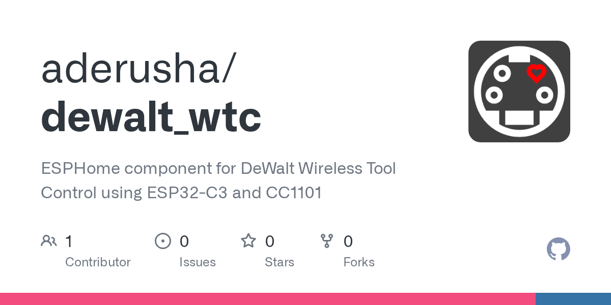

DeWalt has a 433MHz wireless protocol they call Wireless Tool Control (WTC) which is used for one tool to trigger the actions of another. Generally, this would be a tool triggering a dust collector to turn on, or water supply, etc. The radio protocol was previously undocumented, this project serves as an example of how to interact with these radio messages.
Dewalt WTC for ESPhome
https://github.com/aderusha/dewalt_wtc
