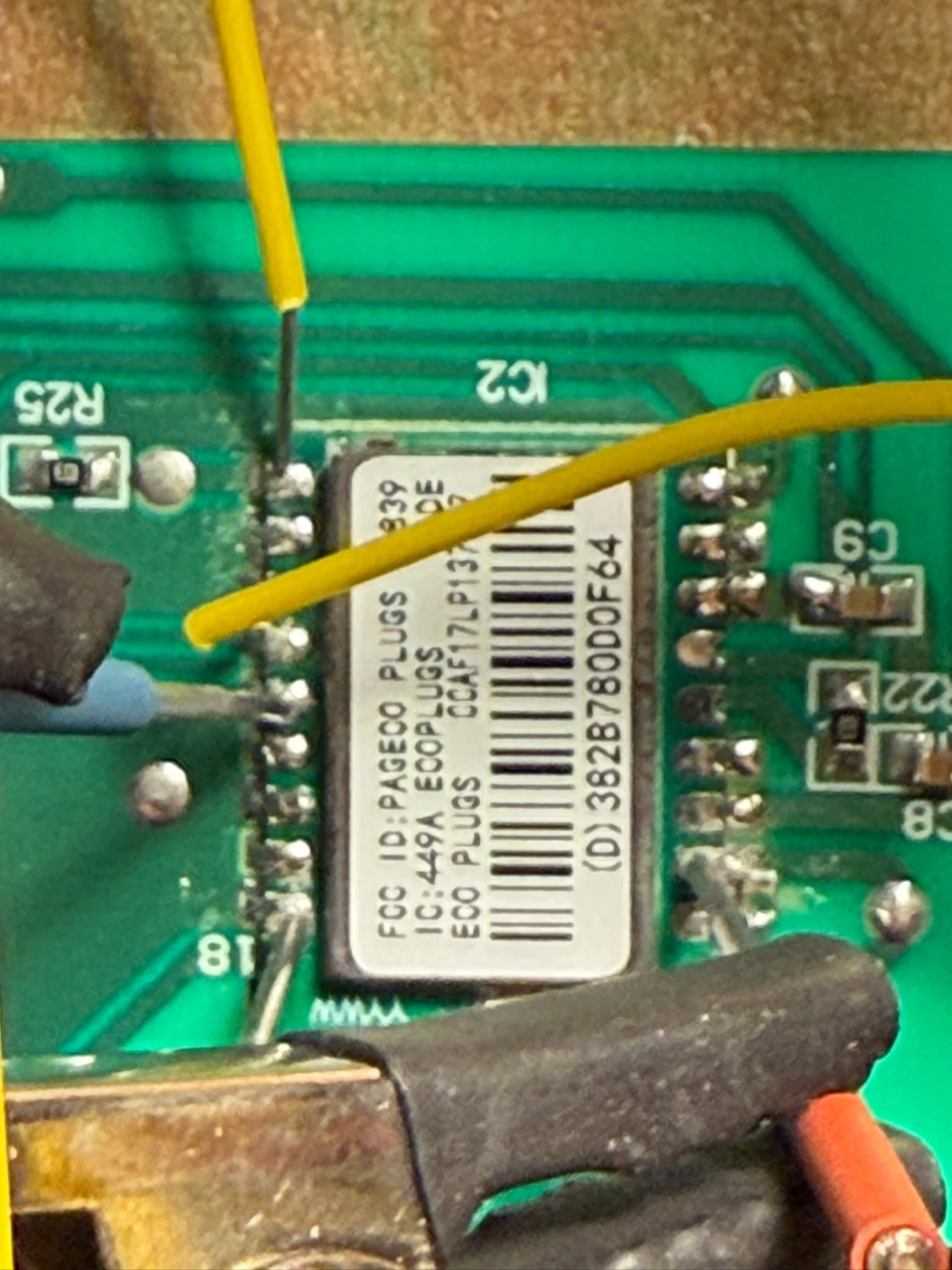

Did some more research and under the covers is an Eco Plus from Kab Enterprises. Once I figured that out there were a few hints how to flash. My problem was I tried to solder wires onto the esp chip and I shorted the Vcc. So the device is toast. I saw some people make jigs to flash commercial devices and that would have been better choice.
I’m gonna just use a Shelly 1 connected to the relays I harvested. I was hoping to reuse the nice neat box for 80 bucks. But lesson learned - gotta be super careful soldering around an existing board.

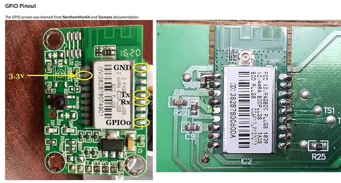

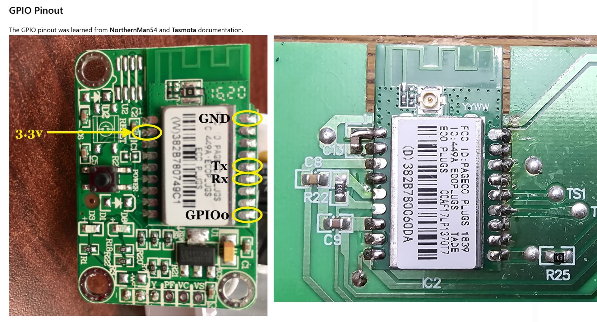

I was successfully able to flash my Dewenwils switch with Both ESPHome and Tasmota. I just created a write up on ESPHome seen here and also the Tasomta flash from here worked perfectly as well. I will be creating a couple other write ups on ESPHome for other branded ECO-Plugs later this week.
Could you share the pinout, the chip on the esphome doc from [ryansmigley],doesn’t ressemble this one… I’d like avoiding bricking it!
@ryansmigley Thanks for that guide - I’m having trouble getting the switch to boot into flash mode. I grounded GPIO0 to pin 10 (ground) is there anything else you did?
@TristanBrotherton Remove power, then jump GPIO0 to Gnd. then power on. ensure there are good solder connections at each point.
Turned out to be a bad board. I appreciate the response!

I can’t seem to get a connection.
Did you ever get yours working? I have the same one as you and I cannot get it to connect to ESPHome to flash. It finds it in the list of USB/Comm devices, but will not go further.
scratch that… I was able to get it to work, I guess I had the RX TX mixed up, reversed them and was able to successfully flash with ESPHome

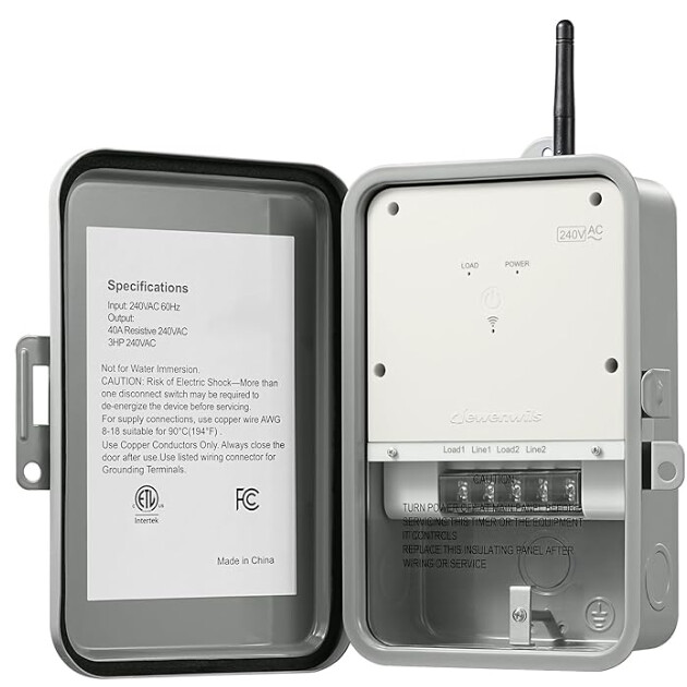

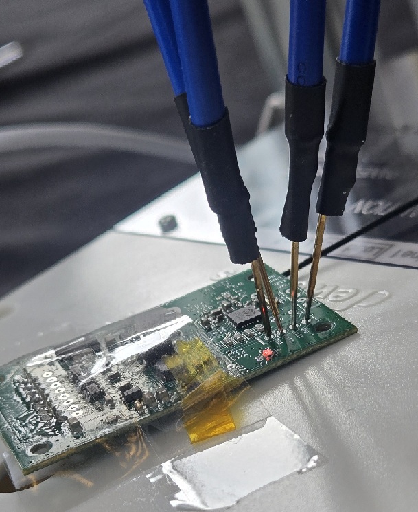

I have a Dewenwils 240V 40A pool timer (PTW04 / SHOWT01F) that uses a Beken BK7231N chip rather than the ESP8266 like this one. If you're looking to flash ESPHome on it, I put together a GitHub repo documenting the entire process.
Looks like the 120V variant (SHOWT01E) is using the same PTW01 control board but a 3rd pair or GPIO would need to be identified in order to make the 3rd relay for the "neutral (load)" works.
