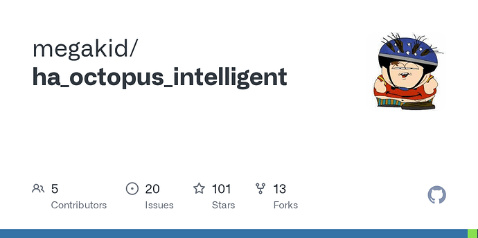

for octopus intelligent
which gives us this off peak end, and intelligent planned dispatch when octopus plan to charge the car outside the normal hours.

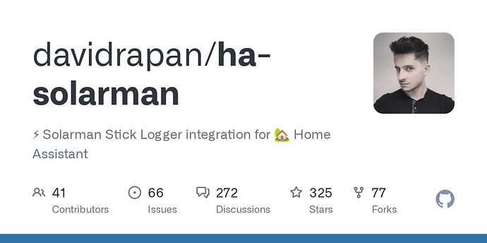

And this for deye inverter
I just entered the IP of the solarman stick thats connected to my inverter - and its serial number and suddenly it pulled all the information - all while I can still control and see my inverter in the solarman or in the deye app.

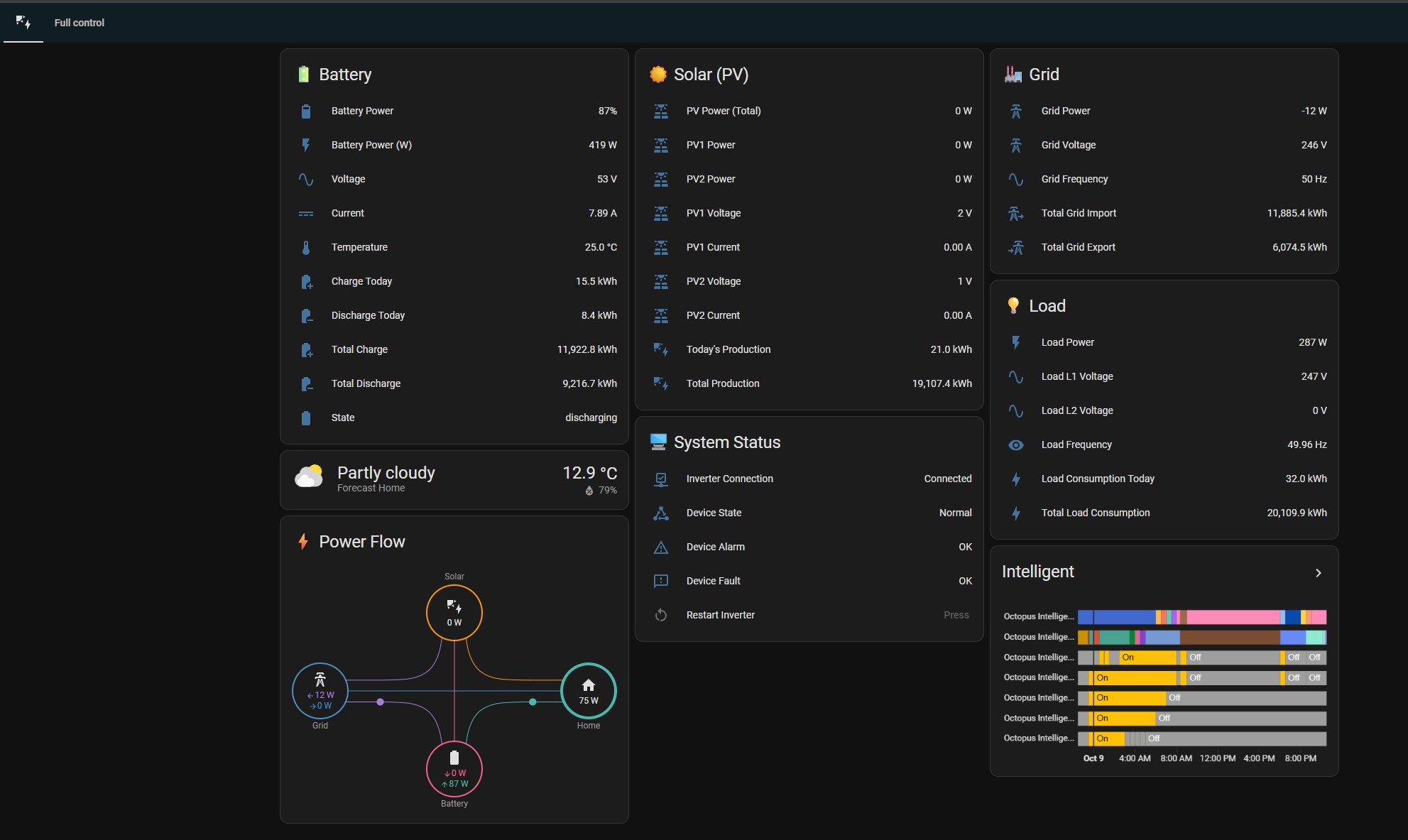

Here is a photo of how the automation looks like:
