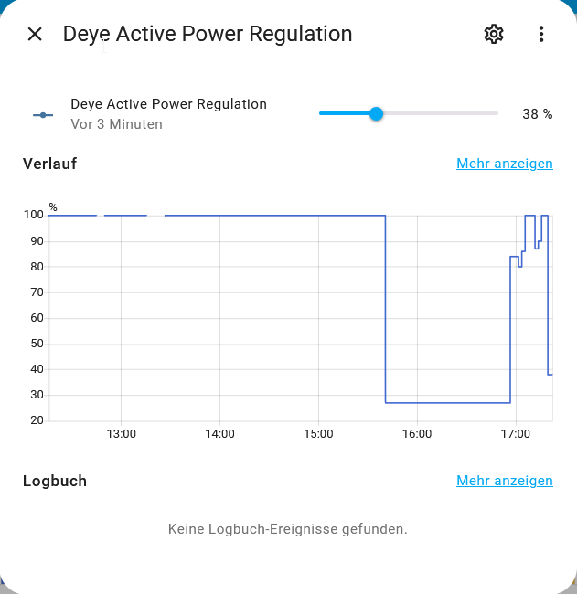

Das Ergebnis:
hey there, since there is a new HACS integration of Solarman and the “writing action” in the scripts above my posts is depricated, here is my acually version of the automation script which use the new Deye-Sensors:
Its now very easy to handle. Have fun
