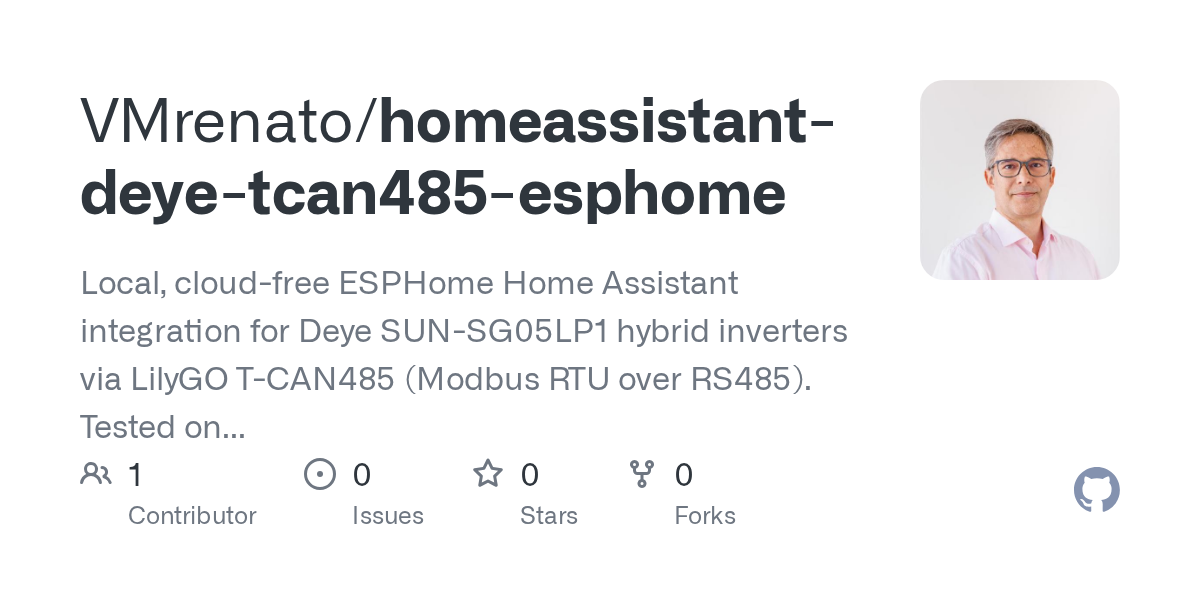

This thread resonates. I’m planning on doing exactly this with the same Deye model I had installed a few weeks ago with my PV. Deye cloud has served me well but I plan to move local now, however I’ve yet to install HA and have only just signed up a moment ago to this forum.
I’ve spent last 3 days musing how to achieve your goal @cdee and am currently awaiting an SSD to mod a Macmini to run HA with the Deye via it’s Modbus port to a ESP32/RS485 TTL gizmo that seems like the optimal solution. The best video I’ve found is from a polish YouTuber. So I’m making a (shopping) list and checking it twice, and plan to have it all rocking by early September. :crossed_fingers:
You may want to check this out:
