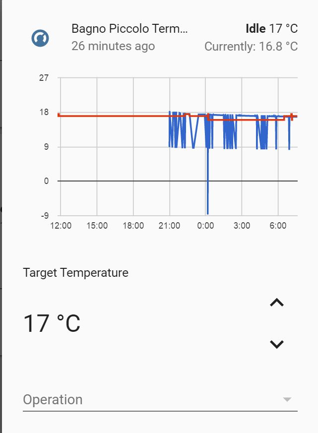

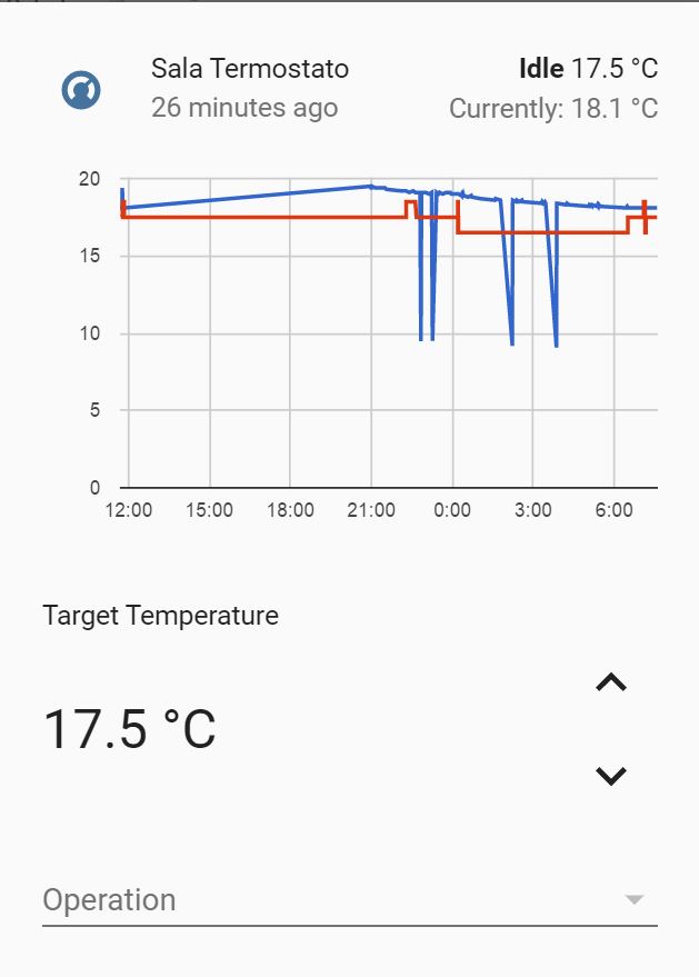

Yesterday I connectect every DHT22 sensor to HA.
This morning I checked I chart of the temperature and unfortunately I found that sometime the readed temperature is wrong.
Here some examples:

I think I found the problem.
I don’t want to use wifi sensor so I wired all my rooms.
As you can Imagine there are sensors near PI and sensors far…
Thinking about that I used a ethernet cable in order to reduce the noise.
I discovered the near sensors work properly, but reading from far sensors sometimes I receive this “strange” values.
What’s the best way to solve the problem? Is there any way to discard them?
