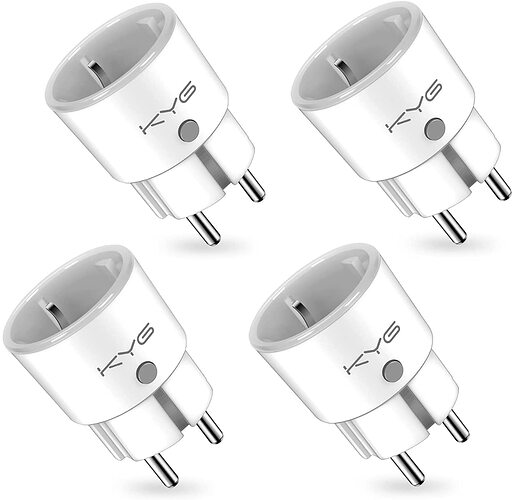

Would it not be easier to just put a smart plug with metering on the computer, then you can read the meter to know if the computer use any power.
yes absolutly, and i bought some that have that function, which works in their app but not in HA integration
which brand and model?
KYG smart plugs connecting via the TUYA app
That looks like a Tuya smart plug.
Those can usually be OTA flashed to tasmota and if that is not possible then a flash to tasmota over a rs232 interface mught still be possible.
nice, yeah i have checking on the firmware of some of my cheaper hardware on my smart home to do list. good to know that i can maybe awaken this functionality.
