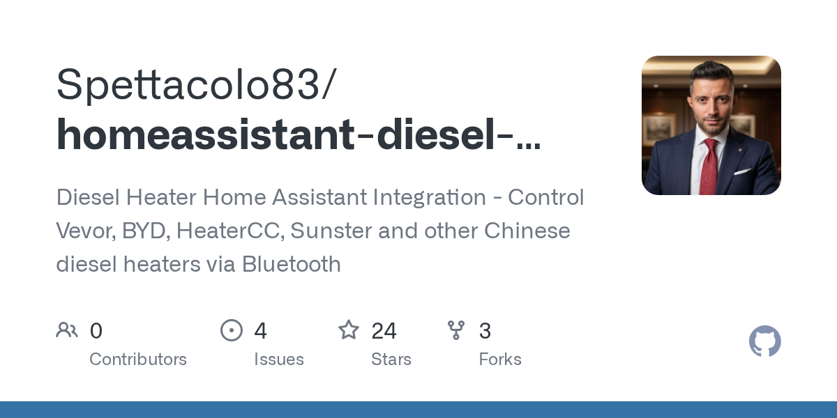

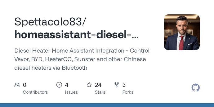

This is what I’m using to control a bluetooth vevor heater:
