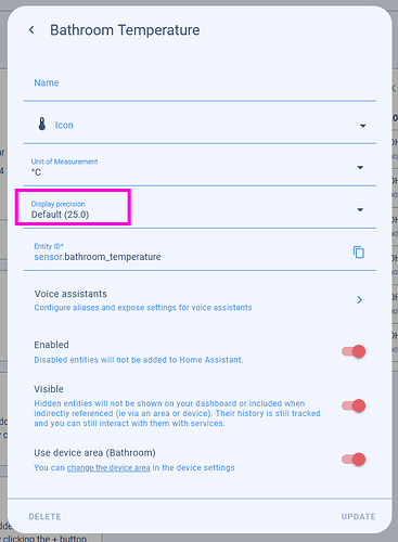

okay I understand. So this is also as expected. I just tested this and can confirm it. I reduced the display precicion in the HA entity settings window and it continues to log to full accuracy.
But the question left is why the decimal places are lost when I transfer a value from ESPHome to HA (just accuracy_decimals set - no round filter).
Can anyone test whether this is only the case in my configuration or is it a bug? Are there any general settings that could affect this?
