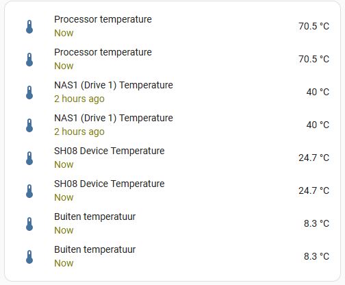

I always assumed that “Last Changed” was the moment that the value was modified and “Last Updated” was the moment that another (possibly not changed) value was received by HA.
I wanted to use the “Last Updated” attribute to check whether the sensor value was still received within a certain timeframe. However, it looks like this is not how it is working.
As a test I added an Entities card with two entries of some sensors, each with both the “Last Changed” attribute and the “Last Updated” attribute selected. I now always see the exact same information for both attributes for every sensor.
Both attributes appear to only reset to “Now” when the value is changed, even though I am sure that some sensors are sending their unchanged value more often.
This are some examples:

Unfortunately these descriptions are (at least for me) rather cryptic: I don’t understand what is meant by “Note that writing the exact same state including attributes will not result in this field being updated” and “This is not updated when there are only updated attributes”.
Who can shed some light on this and can give an example of when the two attributes would be different for the same sensor?
And is it possible somehow to make it visible on the Lovelace frontpage when an (even unchanged) sensor value was last received?

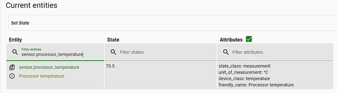

This is from the Home Assistant “State” page:
So this sensor entity has the temperature as state and some additional info as attributes (no humidity in this case).
So there are sensors that show the temperature there as state and the humidity as attribute?
