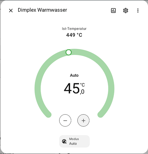

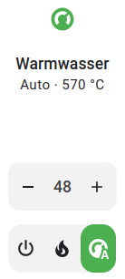

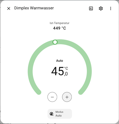

I’m using a Heat Pump (Dimplex SIW 8TES) and after HA Core 2025.8.2 the custom component for modus with the parameter “target_temp_scale” stop works.
Now are current and target temperature incorrect.
I’m wondering why not more other user have this problem.

I have now encountered the same error. I also have a Dimplex LA 12S-TU heat pump. Different scales for the actual and target values.
